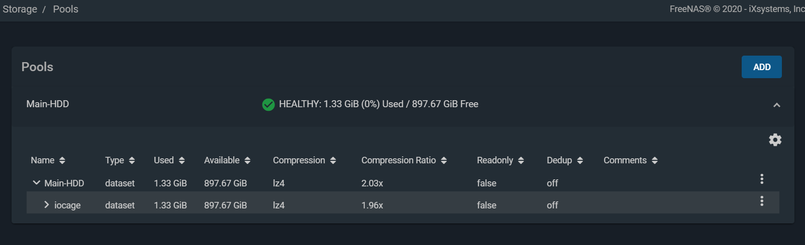

hi,
so I've ran the 'git clone https://github.com/danb35/freenas-iocage-plex '
But now I'm on this bit -
JAIL_IP="192.168.1.75"
DEFAULT_GW_IP="192.168.1.1"
POOL_PATH="/mnt/tank"
These values must be set. They correspond to:
  • JAIL_IP and DEFAULT_GW_IP are the IP addresses of the jail and your router, respectively.
  • POOL_PATH is the path for your main data pool's root directory.
Where do i find the 'main data pool's root directory'? This is my drive below.
Jan 4, 2014
1,644
Best that you post this in the discussion area for the resource so that other forum members with similar script issues can benefit from the discussion. You may want to look in the discussion area as there may be some clues that will help you resolve your issue. I would also suggest that you have a look at the forum rules to understand forum etiquette.
