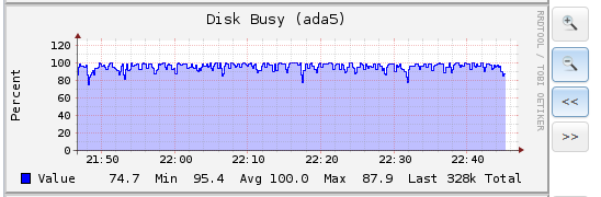

I put in 4 more Disks for a another try and performance is increasing. So i probably will move everything to another chassie. But i have one last understanding question. I put in the SSD... as ZIL and L2ARC Cache.
Clipboard - 25. September 2017 22-49.png SSD is 100% busy

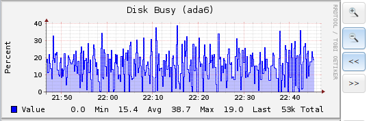

all other Disks are not nearly as busy as the SSD
Does that mean the ssd maybe slowing down things? Latency on the normal disks is about 1.5 - 1.8 ms and the SSD is at 5 ms writing and 11 ms deleting. Just trying to get into this. Right now i have only 8 Disk in, not the recommended 12 but in the recommended configuration 2 disks mirrored in 4 vdev's.

UPDATE: I did remove the ZIL Cache while backing up... and boom it was like unleashing something. Performance instandly doubled from 1G/s to 2G/s incomming datastream :)
Yes, a regular consumer SATA SSD is going to be slower than the pool. To get the kind of IOPS you need for this from an SSD, it would need the connect directly to PCIe like the one @Stux used in his recent build.

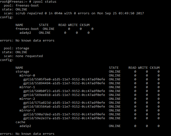

Based on what you said, you either are using the wrong terminology, or you didn't configure the disks the way I am trying to convey.
I will make a diagram to try and illustrate.

In the pool illustrated, each mirror is a vdev (virtual device) and the pool is a stripe of all the mirrors. This gives the most IOPS (speed) for the available number of disks. I illustrated two hot spares, but you can skip that if you are not adverse to the risk. Don't skimp on this. The spares are for the sake of reliability and you will want to keep an eye on it.

i think besides the cache, that looks very much alike. And as i said, yes i can see a hugh performance increase. It's much better now :)
