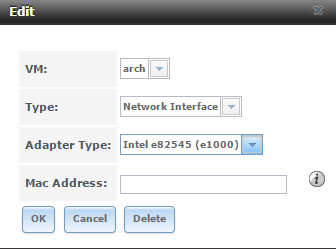

Have you tried selecting your actual network card instead of VirtIO? Select you VM, click Devices at the bottom, select NIC and click the drop down where it says Adapter Type.
It should auto detect your hosts network and use DHCP from your router to assign or pickup and IP.

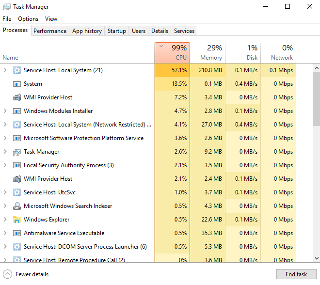

That works but the CPU spikes to 100% and its hard to use, even locks up.
It works fine on Ubuntu but Windows server 2012R2 and Windows 10 have an issue.
I read to try the VirtIO driver to resolve this but have no clue how to work with it. CPU runs fine on VirtIO but without network access.
