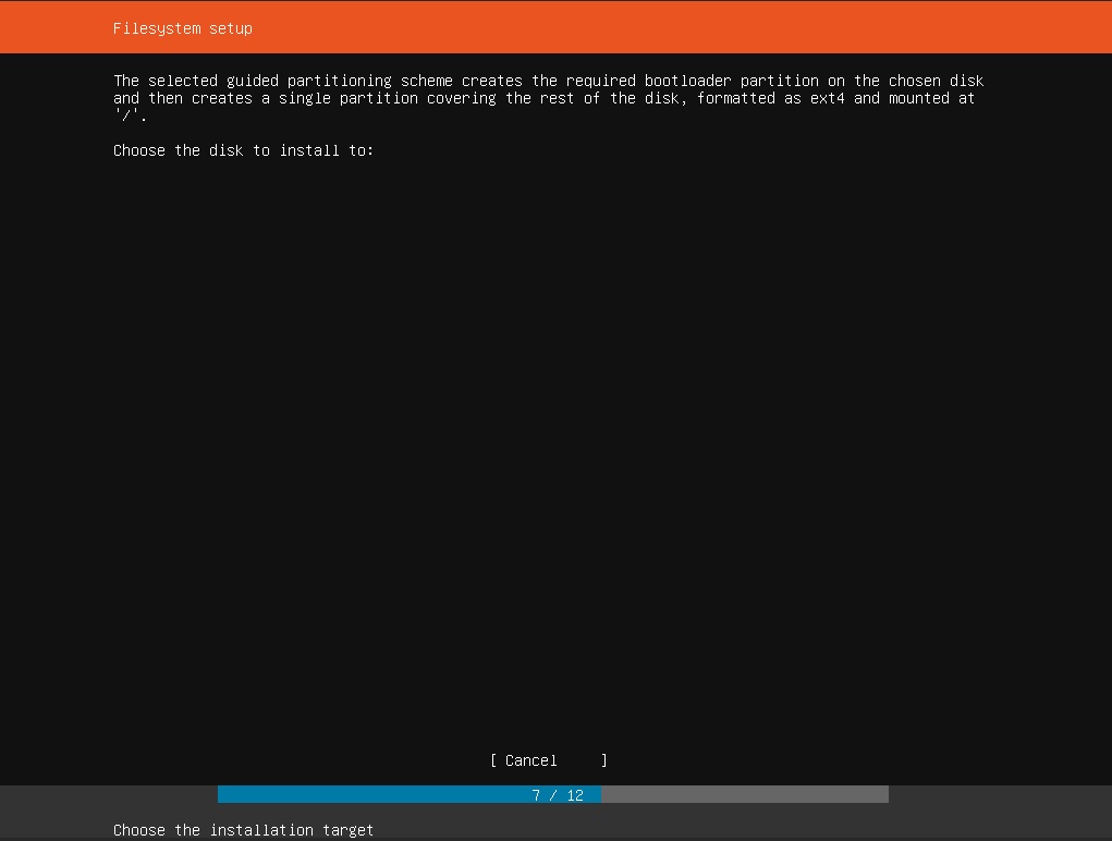

I am trying to create a VM follwoiung the exact same sequece I have used in the passed.
01. Created VM
02. WITH HDD 1.5 TB
03. Boot VM off ubuntu.iso [18.04 LTS]
04. GET to Filesystem setup
05 NO HDD
Why is ity doing this?

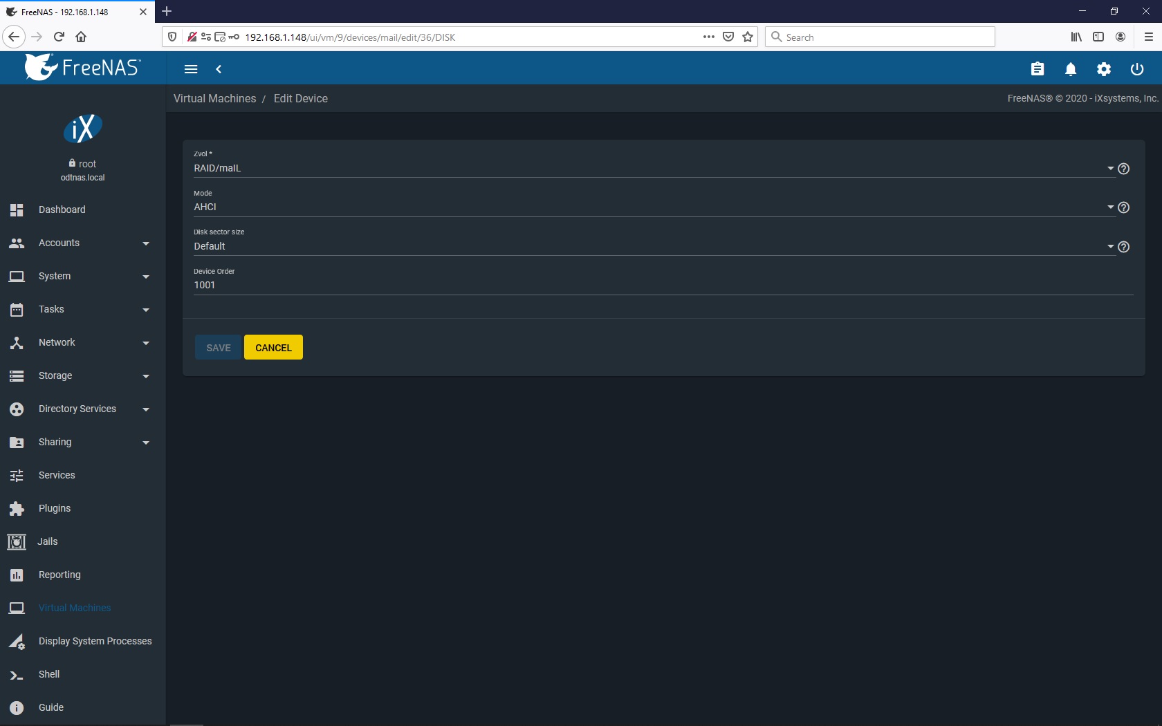

Please show the "Device" settings for the HDD of your VM ...
Thanks,
Patrick

Looks good. I installed Ubuntu 18.04 about a dozen times without a hitch. You should use VirtIO instead of AHCI, though. Could you just try if that changes anything?

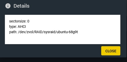

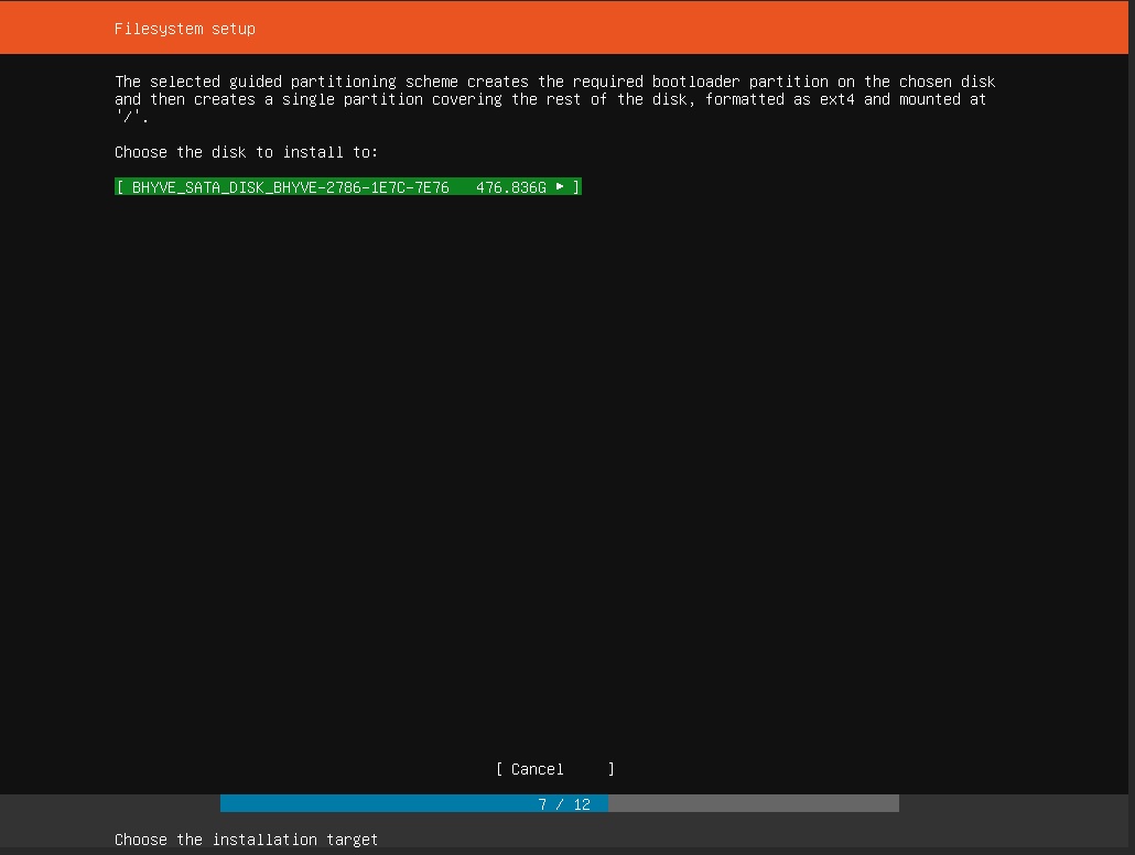

changed where the hdd points seems to work, not sure why.
