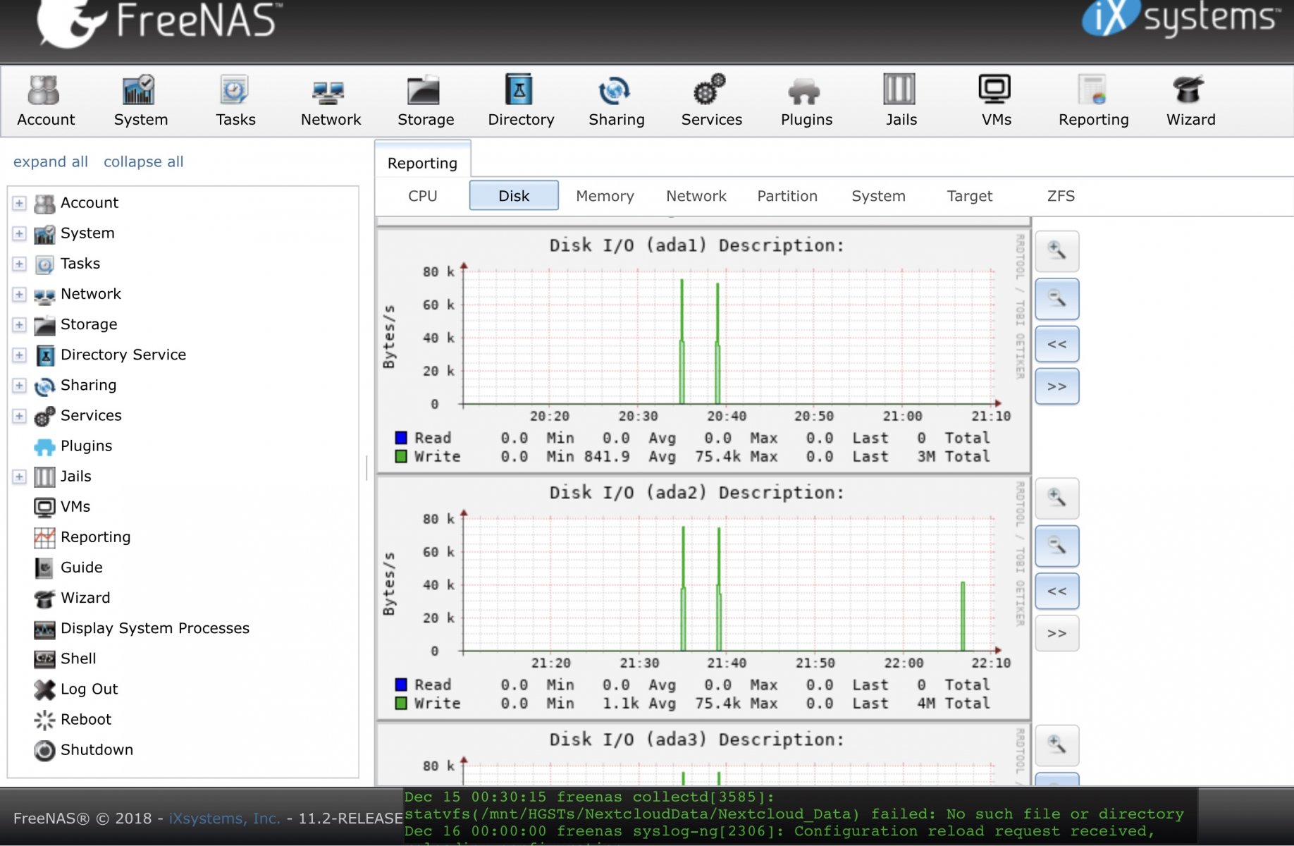

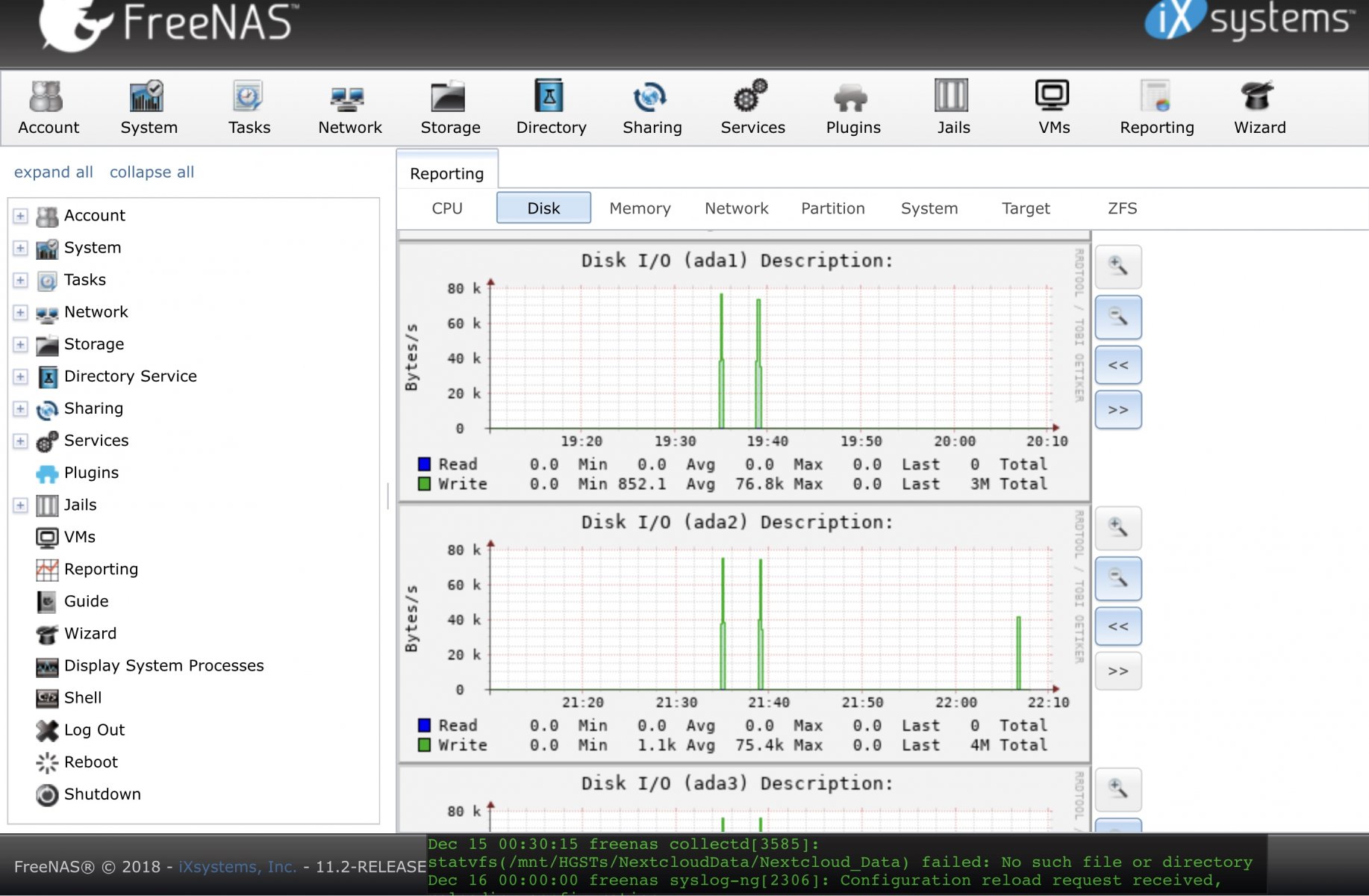

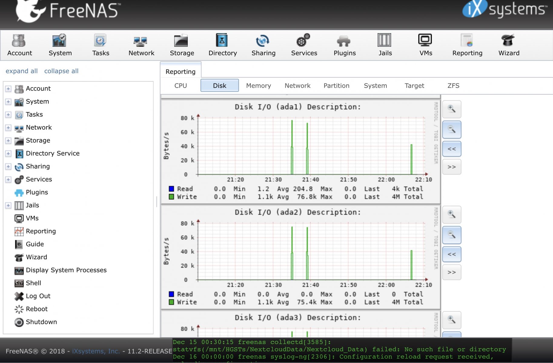

Hi everyone.
I successfully upgraded to Freenas 11.2 from 11.1 U6 via the GUI.
So far I really love the Update, but since 11.2 something wakes up my HDD RAIDZ1 every hour at more or less exactly XX:35 hour.
This really annoys me, my power saving plan depends on that RAIDZ sleeping :D
Any hints where to look or what the culprit might be?
Thanks!
6AA09DE7-E44D-44DB-B3BB-339BAB9B6C07.jpeg E9FD66D5-8639-4302-949D-9A2AFFA08B8D.jpeg D113B105-C7A7-41F1-BFCB-94B02A0173E8.jpeg

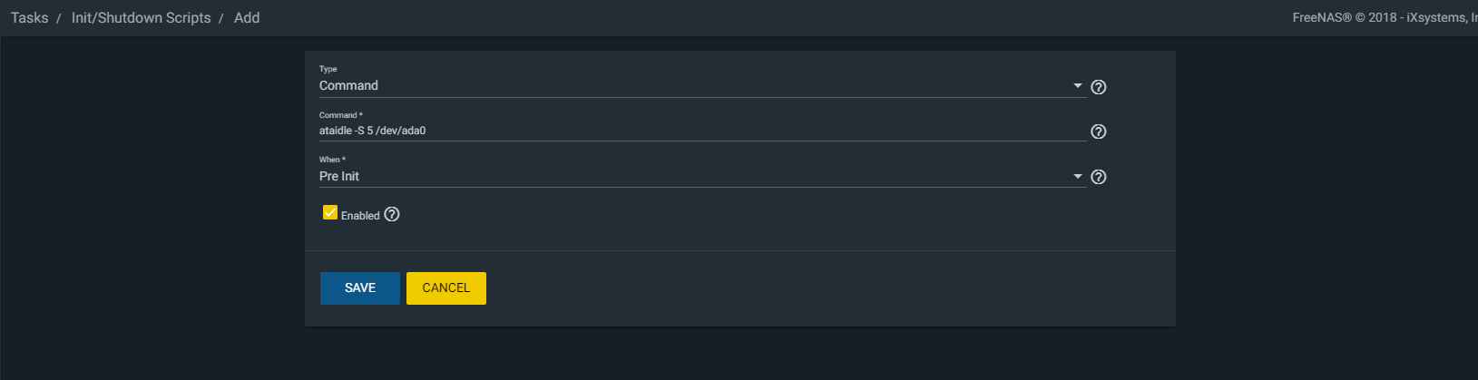

Same here: After updating to 11.2 no standby any more. System dataset is on SSD.
Pushing the drives manually to standby by e.g. "ataidle -S 5 /dev/ada0" works, but they'll wake up after some time.
Also interesting: My drives are encrypted and locked after reboot. Even in that case they won't spin down. While the drives are locked, the iocage is not accessible. That implies to me moving the iocage to the SSD as well wouldn't help:
https://forums.freenas.org/index.ph...ng-the-iocage-dataset-to-an-other-pool.70168/
I have the same issue here. My freenas system HDDs wont go to standby mode. All my Jails already migrated to a SSD, and freenas boot system running in a USB thumb drive.
I have four (4) HDDs that I want to push manually to standby mode.
How do you enter the above command to make all the four HDDs go to standby mode in one line? Do I need to use comma or semi-colon to separate every command on each HDD?
I even instruct the drives to immediately go into Standby mode but that didn't make any difference. See attached screenshot.
