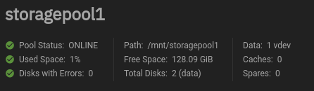

Sorry, I should have written "TrueNAS equivalent of raid" - I have two drives paired for TrueNAS, two that I want to use in this application, then two more for additional uses. This is what StoragePool1 looks like ...
