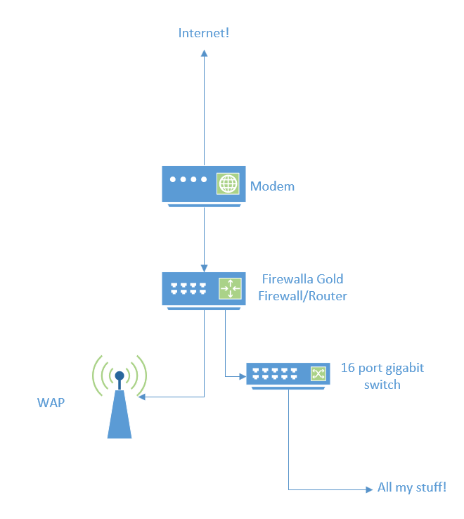

I've thought about this too, but I don't have anything with 10G to support that link on the other end. My network topology is currently very basic since I haven't really had anything to justify getting any new network equipment that would actually utilize 10G but maybe this would be that occasion! I probably would not get it at first, but would add it later. I've attached a basic layout of my my current topology.
My current setup is all of my stuff is in a 25U freestanding rack. This includes my network equipment, my gaming PC, a couple UPSs, and some audio equipment.
Appreciate the reply! Thank you.

If your priority is support for serving media and using Plex, then you do not need 10G networking. I would focus on building a stable system now and leave 10G networking for later. As for memory, 32GB should be plenty to start with. You can purchase a single 32GB memory module to start. You will not see any realistic performance difference between two 16GB modules and one 32GB module.

I think that's going to be the plan for now, re:10G networking. Don't need it for sure to start with, maybe one day as a nice to have if I actually think I'll get some benefit out of it.
