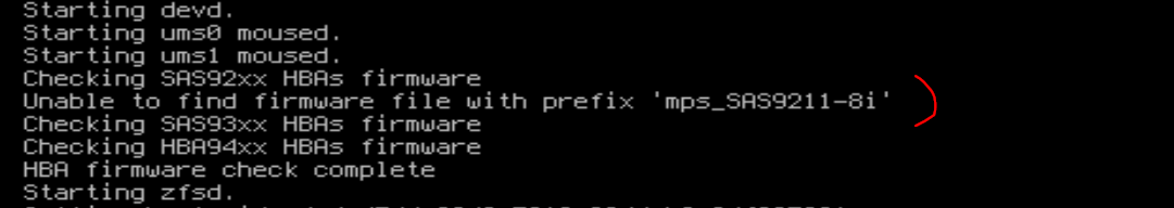

I've just upgraded to the latest TrueNAS Core (at the time of writing this) and I've noticed the following message during boot:
I don't remember seeing this on TrueNAS 12, but everything seems to be working fine.
The controller I'm using is one of those proprietary Dell ones (that drop into the special slot of PowerEdge servers), that I've flashed with IT firmware.
Just looking for confirmation that I don't need to worry about this.

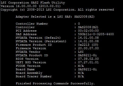

Here's the output of sas2flash:
This is the latest, right?

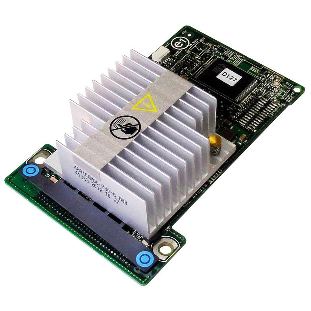

The controller looks like this:
I believe it's the H310 Mini Mono. It was very popular on the x20 generation PowerEdge servers.
9,700
Looks OK as far as I can see.

20.00.07.00 is the correct firmware you are supposed to be running. It looks like they've changed the firmware validation once again, which is really good because the old check was dodgy and sucked a bit. I thought they had actually bailed on trying to validate.
