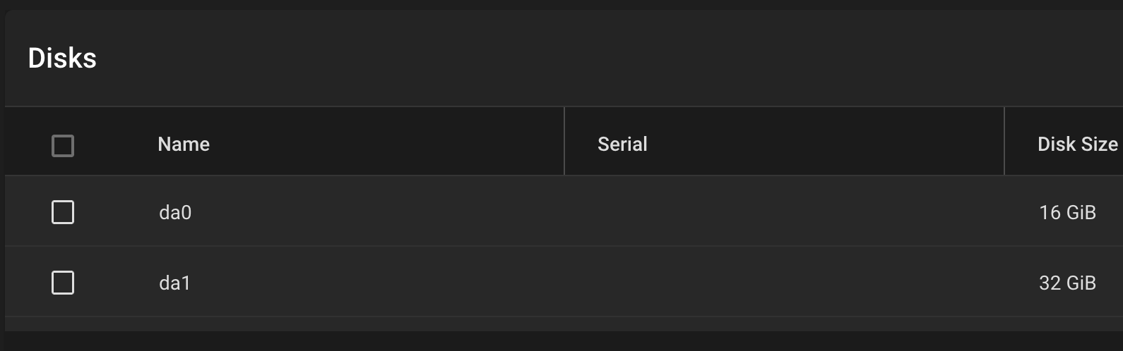

Well, the GUI does show serials in the storage/disks page:
(serial is blank here because this is a virtual environment). I don't think it'd be bad to have them listed elsewhere, though. Feature requests are made through the bug tracker; use the Report a Bug link at the top of the forum page to get there.

I did see serial numbers are listed, but that is my issue; I'm given a device ID in an error, and nothing in the disk information matches that information. My idea is to eliminate having "decode" the obscure device ID using the shell, and instead, be able to use the alert information directly.
