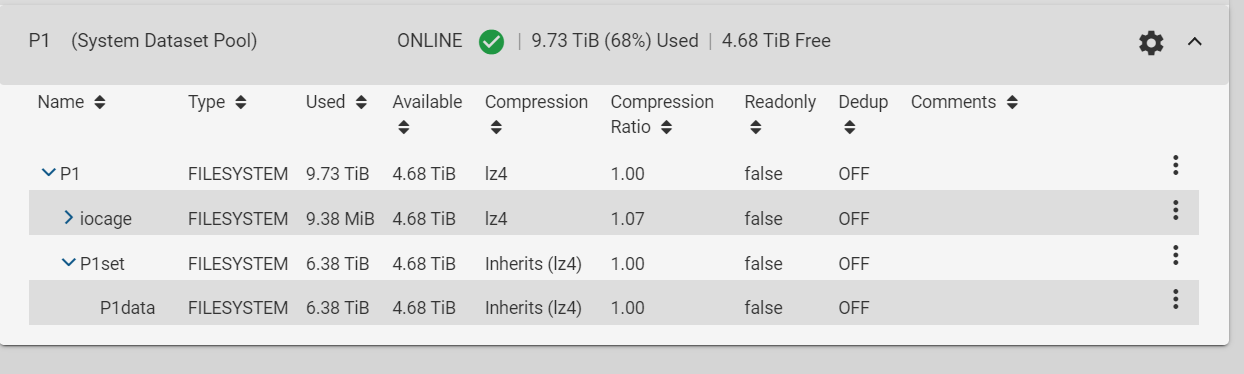

I am new to TrueNAS and appreciate confirmation of the following, having read a number of messages on this topic.
I started with 3 8TB disks primarily as a trial. I want to expand it by 1 disk, total 4 disks (2 disk fault tolerance). Data is personal and family stuff - when this includes decades of photos, it gets "costly" if lost. Yes, I know the importance of backup which is not the primary aim of RAIDZ. Backup is taken care of.
Current - see pics below.
3 x 8TB
No "mirror"
Upgraded
4 x 10TB
Mirror (also 4 x 10TB)

This came closest to what I hope to do https://www.truenas.com/community/threads/convert-raidz-1-to-raidz-2.26187/. I have yet to buy new disks as I want to be "sure" what I am doing even if starting again. Starting again means copy data (backup) to some external drives, set up new NAS, and copy data back. Permission-wise it is root plus one other global user. Buying 5 disks (add 1 to first vdev, remaining 4 forms 2nd vdev) is $£€ but I want to learn.
