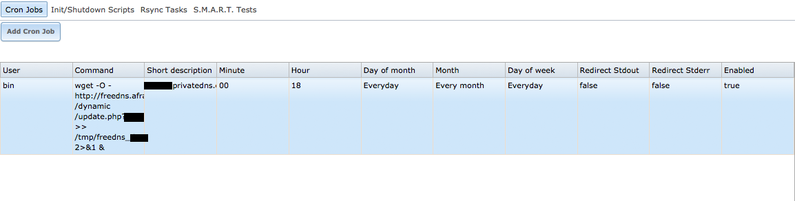

stefanb
Dec 12, 2014
200
Set the intervals as you like/need.
Mine:
I only need one update at 18:00, cause at 18:30 the rsync offsite-backup starts and my IP will only change 3-4 times/year
S.
