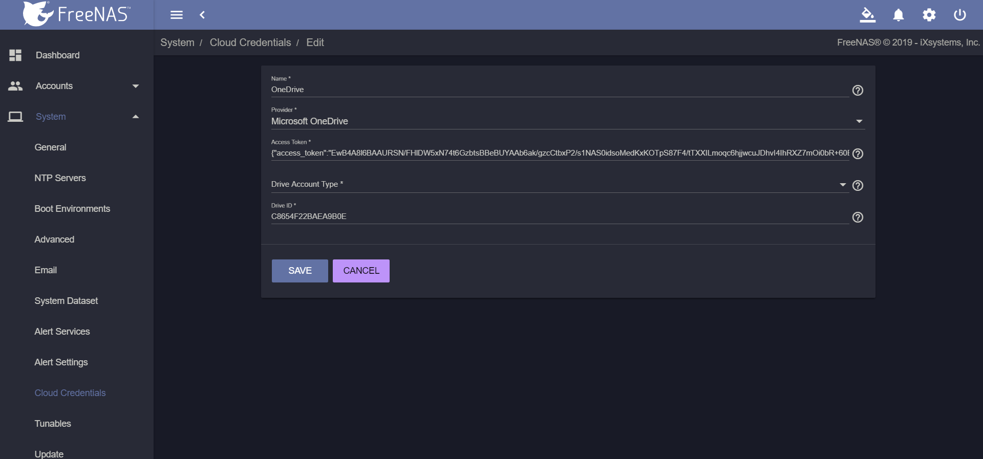

I started to have some problems with cloud credentials for a OneDrive personal account after upgrading to 11.2-U5. The problem is that the settings for Drive Account Type as "PERSONAL" in Cloud Credentials is not saved and hence each time rclone is trying to make a sync is giving the error below:

I have noticed that if I am very quick and input the PERSONAL setting in Cloud Credentials and then in less than 5 seconds I start the cloud sync task manual rclone is starting to sync my OneDrive folders to their equivalent volumes on FreeNAS. However the setting is then deleted again from Cloud Credentials and the cloud sync task gives the same error above.

In the meantime I pinpointed more accurately what is happening:
- the bug was introduced in U4.1 and was not solved in U5
- the value "PERSONAL" of Drive Account Type is lost only after a sync
- the sync works perfectly if I put back manually the setting again
- I've notice a new error in RClone config: "Failed to save new tokken in config file: section "onedrive" noy found"
I will attach 2 new screenshots: one with the error above and one with the setting missing after the sync.
