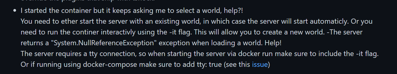

is there a possibility to set the -i flag with Truenas Apps?
I am trying to run beardedio/terraria container - but I am getting an error.
According to the FAQ:
The server returns a "System.NullReferenceException" exception when loading a world. Help!
The server requires a tty connection, so when starting the server via docker run make sure to include the -it flag. Or if running using docker-compose make sure to add tty: true (see this issue)
I cant find a way in the app settings to set -i / -it or tty: true flag.
Is there any way?
Thanks in advance.
