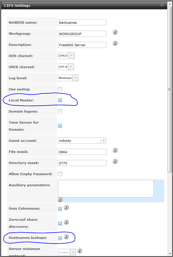

Let me find it and get the link. Here are the setting in my freenas by the way. on the picture

Mine has both enabled and I have no issues. I would prefer leaving the host name lookups enabled so that I could restrict hosts by names instead of IP addresses. That makes it a little simpler from an administrative perspective (at least for me); since I run DHCP for the other clients.
