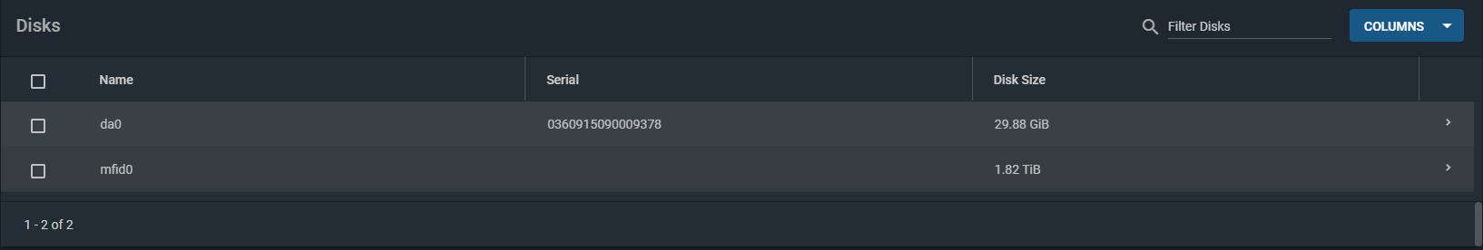

Go to menu >> Storage > Pools : It's completely empty
Go to menu >> Storage > Disks: I can see two disk (the USB one on it it's installed Freenas and the storage one)

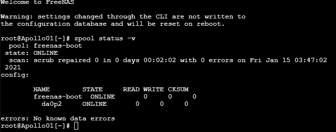

Go to shell:
and

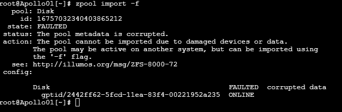

You may have success with:
zpool import -f Disk
You have chosen a name for your pool that is making it complicated for you to understand ZFA terminology.
Good luck with the import attempt.
Given the message about metadata corruption, you may find that your pool is unable to import in the current state, in which case you may find more success with -F (which can discard the last few changes in order to recover the pool... but can drop some of your data in doing that).

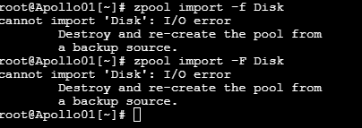

First, thanks for your answer. I try to set the command as suggested with no success. Look here:
What can I do? The data is not so important but all the configuration (access and so on) it's quite important... At the end of the day if is not possible to restore the disk I can delete it but I need to mantain the pool and the information in it...how can I solve?

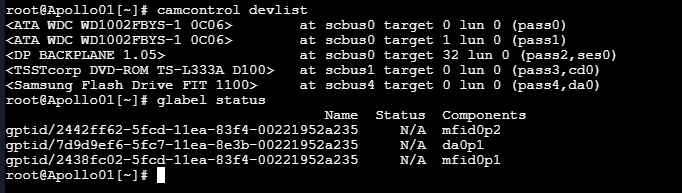

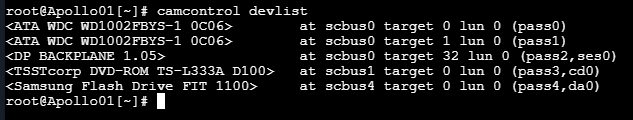

OK, so there's some kind of problem with the disk... are you able to get some output from
camcontrol devlist
9,700
And glabel status?
9,700
I'm trying to work out which disk is underneath that pool and see if we can get a smartctl -a run on it.
Can you detail your hardware a bit more?
It seems you have a backplane between the system and the pool disk... what kind of case do you have?
What kind of disk controller?

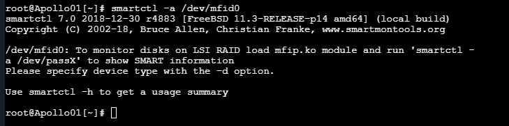

let's try the smartctl:
smartctl -a /dev/mfid0
So I installed FreeNas on an old DELL server that is a PowerEdge 1950. I had two SATA disk of 1 Tb each and there is a RAID controller behind them. I should have put everything in RAID 0 infact on FreeNas I see this:
I try to put your command. Here it is the result
