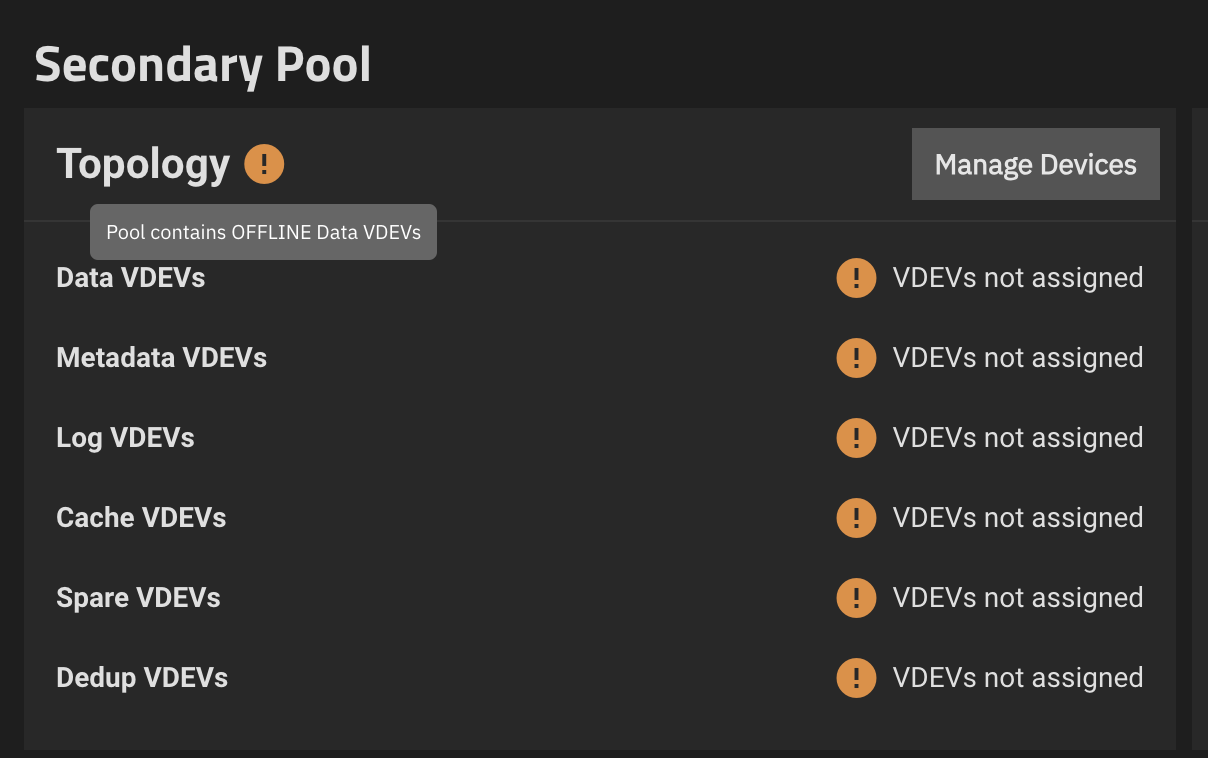

After the upgrade, a pool is not available. System tells that no VDEVs have been assigned and in fact there is no dev in the Pool. (attach images) .
In fact, there is an unassigned disk in the storage section.

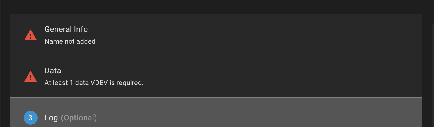

If I try to add it, from GUI, system tells me that Name not added/ al least 1 dada VDEV is required, despite having added the right pool name and disk.

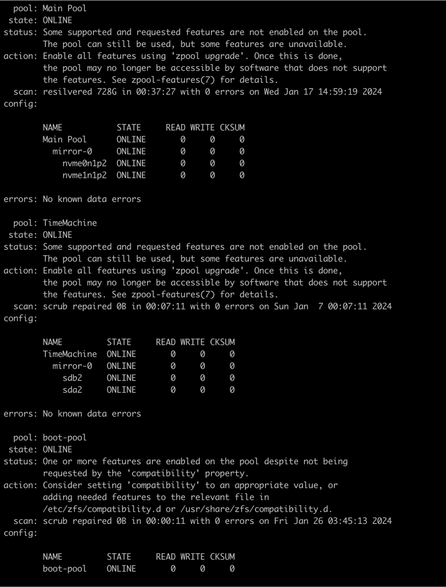

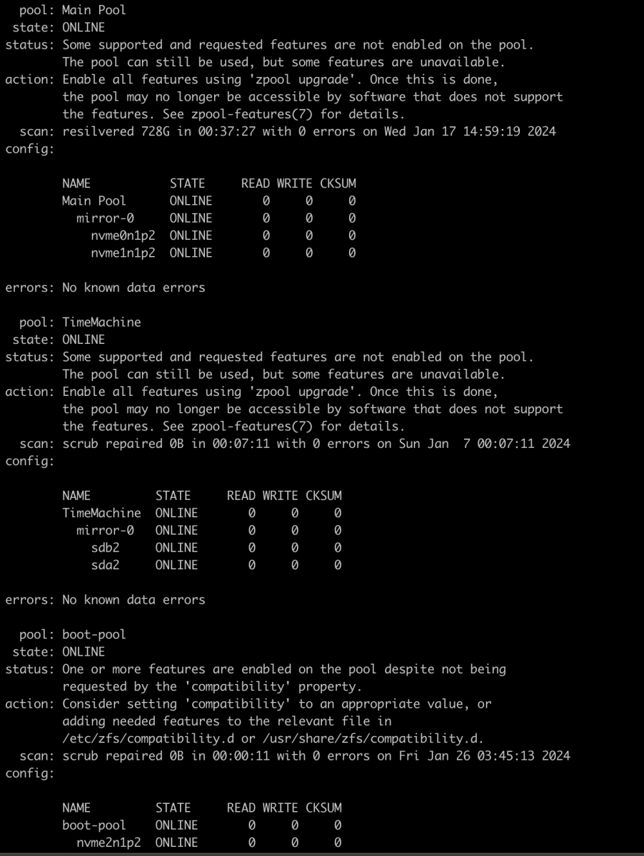

If I run zpool status, the pool does not exist anymore

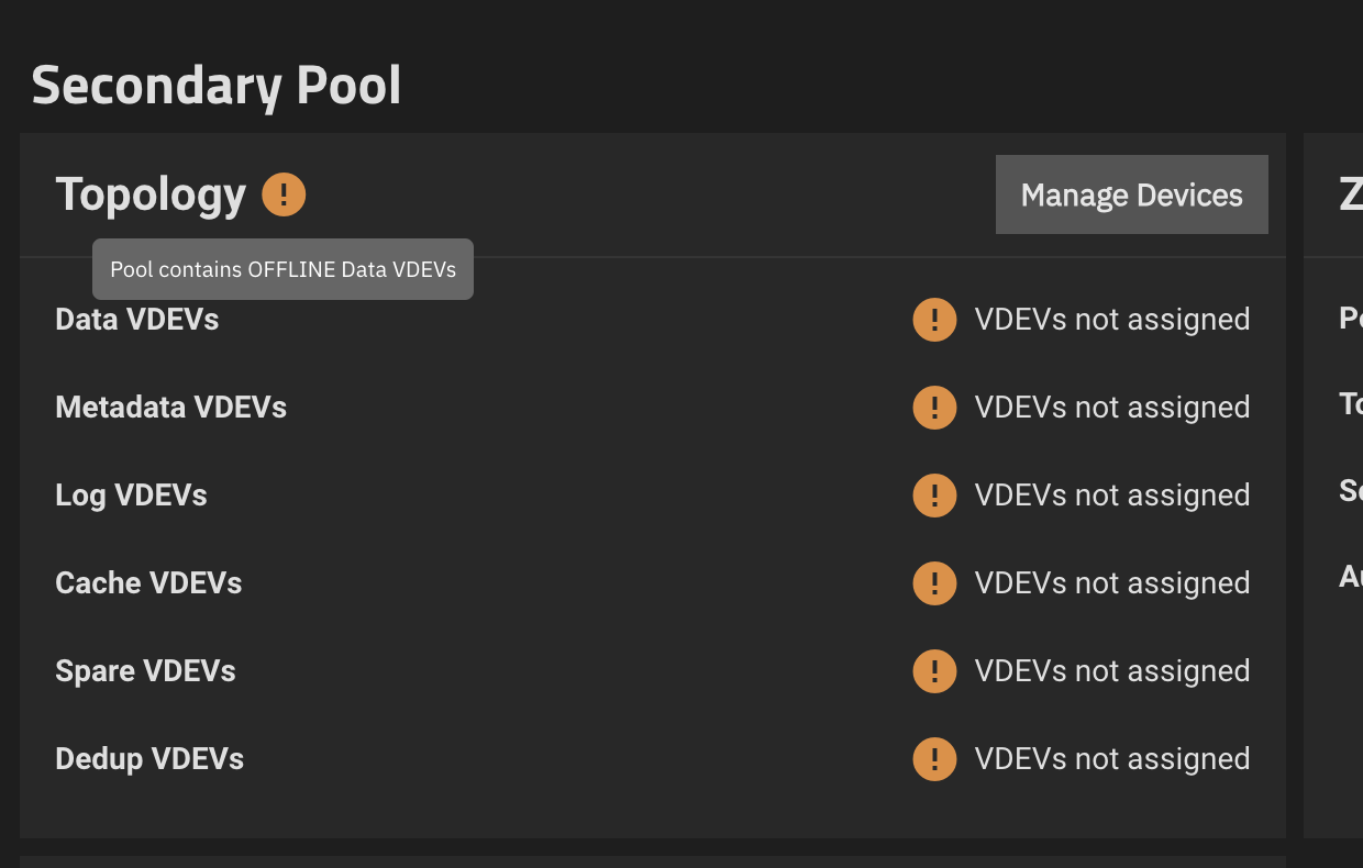

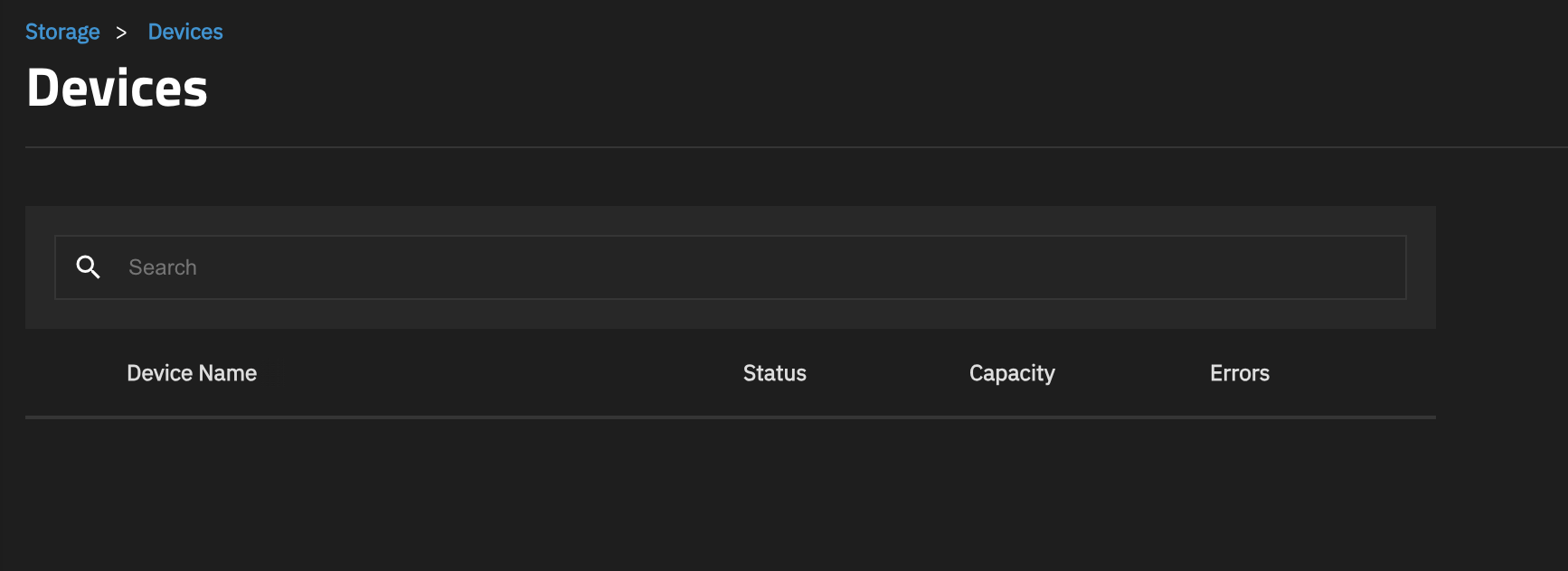

Ok rollback to previous version and reupload of the config was unsuccessfull. Still disk unassigned, pool only visible in the GUI and not via zpool commands.
