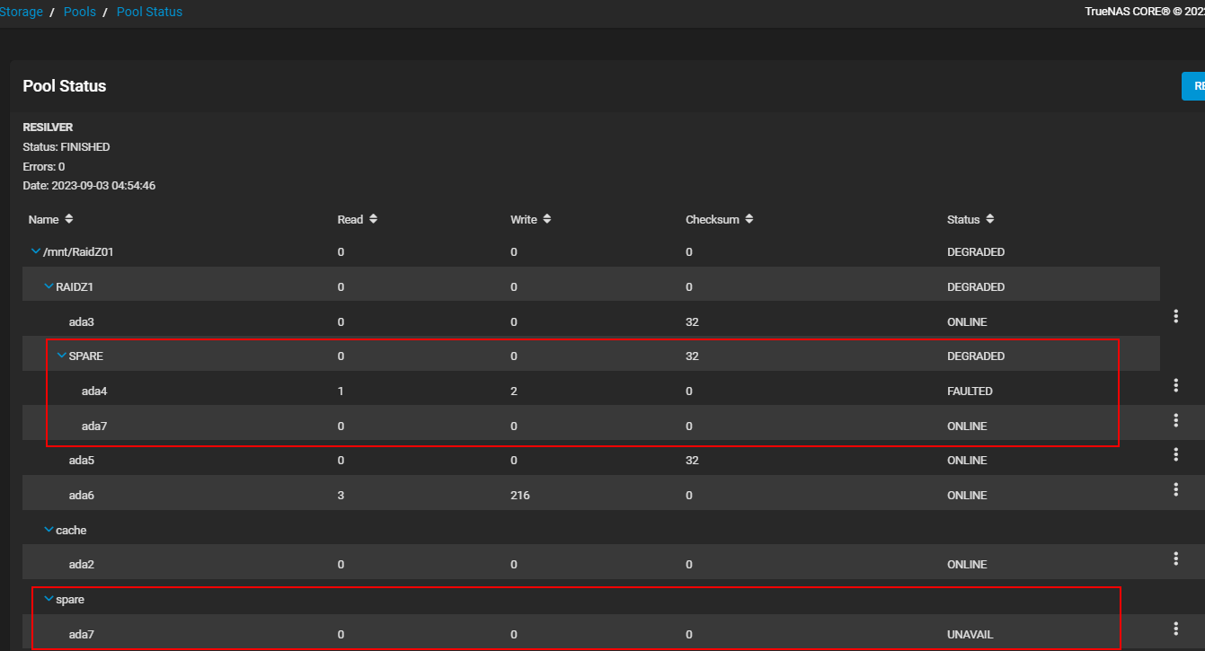

Hi
yesterday I fall into an hard disk failure and I need help to correctly solve my situation.
I have a Poll with 4+1(spare) disks.
Now the Pool is in degraded state and this is the output
Now the question:
1. which steps I need to follow to put the pool in Healthy state again?
2. how can I identify the faulty disk? Is there a way to remove the disk sata cable safely, one by one, to find the ada4 faulty disk?
Thank you
You need to find ada4: Storage>Disks will list the drive serial numbers by drive name - note the ada4 serial number, shut off your server and open it up, find the bad drive by serial number and remove it.
Replace it with a new drive, hopefully one already tested/burned-in, from your shelf. Restart your server and allow the pool to resilver the new diisk.

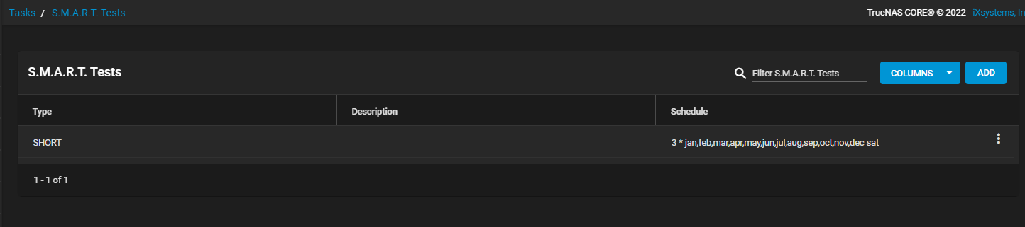

Hi
this is my smart test schedule
the only faulty disk to me is ada4, there is no avidence of other disk issues. Am i missing something?

Just the last question: why the pool is still degraded even if the spare disk replaced the faulty one?
Is this normal?

Oh yes you are, you are only running a SHORT test, this is a basic quick test to ensure the hardware is operating, it does perform a very small surface test but that is more to ensure the drive is just working, it does not surface scan the entire drive for defects, that is what a LONG test does.
My advice, and what I always advise for a person 99% of the time, run a daily Short test and a Weekly Long test. If you do not use your NAS at night (everyone in bed) then running the LONG test is best for those times, whilst the SHORT tests only take a few minutes (typically less than 2 minutes) so those can be done anytime. My schedule is to perform a Daily SHORT test at 1 AM and then schedule a Weekly LONG test each Thursday at 1:05 AM. This is the easy way to schedule the testing over scheduling a SHORT test for all but Thursday. If your drives run 100% of the time then there is no impact to the drive life, if you sleep your drives most of the time then I'd recommend possibly a different schedule.
Is this normal?
Yes, until the resilvering is completed and your "Spare" should detach automatically.
If you still have a degraded system after, please post.

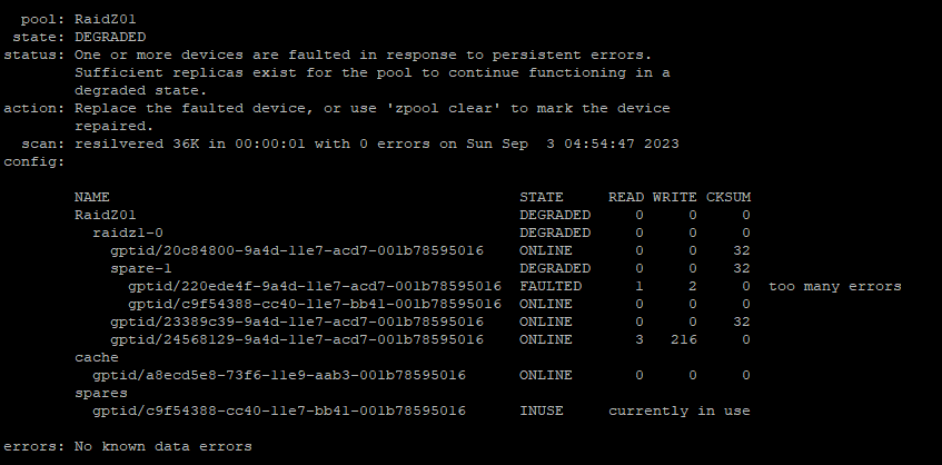

This is current situation
pool: RaidZ01
state: DEGRADED
status: One or more devices are faulted in response to persistent errors.
Sufficient replicas exist for the pool to continue functioning in a
degraded state.
action: Replace the faulted device, or use 'zpool clear' to mark the device
repaired.
scan: resilvered 36K in 00:00:01 with 0 errors on Sun Sep 3 04:54:47 2023
config:
NAME STATE READ WRITE CKSUM
RaidZ01 DEGRADED 0 0 0
raidz1-0 DEGRADED 0 0 0
gptid/20c84800-9a4d-11e7-acd7-001b78595016 ONLINE 0 0 32
spare-1 DEGRADED 0 0 32
gptid/220ede4f-9a4d-11e7-acd7-001b78595016 FAULTED 1 2 0 too many errors
gptid/c9f54388-cc40-11e7-bb41-001b78595016 ONLINE 0 0 0
gptid/23389c39-9a4d-11e7-acd7-001b78595016 ONLINE 0 0 32
gptid/24568129-9a4d-11e7-acd7-001b78595016 ONLINE 3 216 0
cache
gptid/a8ecd5e8-73f6-11e9-aab3-001b78595016 ONLINE 0 0 0
spares
gptid/c9f54388-cc40-11e7-bb41-001b78595016 INUSE currently in use
errors: No known data errors

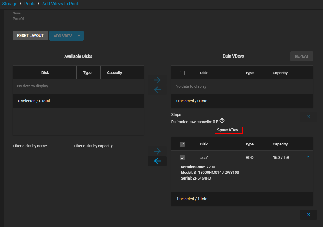

I'm back, I finally copied all my data to a new Pool which is 1 disk done.
Now I'd like to add a second disk (same type and size) but I'd like to have a RAID10 configuration, could you kindly tell me how to achieve that?
I want to add it as Spare, is this correct to achieve that configuration?

Thank for advice, but It would be better to have an illustrated guide, just to be sure.
I had the chance to figure it out by myself and the point is:
After a vdev is created, more drives cannot be added to that vdev
So here the points:
1. I created a Pool with 1 disk, I cannot convert it to RAID10, I can add a second disk but just as spare (for redundancy)
2. To achieve a RAID10 pool I have to create the pool with at least 2 disk with "mirror" option. Now the pool is RAID10 and new disks can be added, 2 at a time, to increase size.

NugentS
Apr 16, 2020
2,947
@Mattia3rd
As @Heracles says - add the new disk to the first, in the same vdev. Not a spare. I believe extend is the correct term. Make sure NOT to add the second disk as stripe. Adding the second disk as a spare would be a complete waste of time. If you extend the single disk vdev then it turns into a mirror (similar to RAID10)
"After a vdev is created, more drives cannot be added to that vdev"
Correct for RAIDZ, not correct for mirrors
