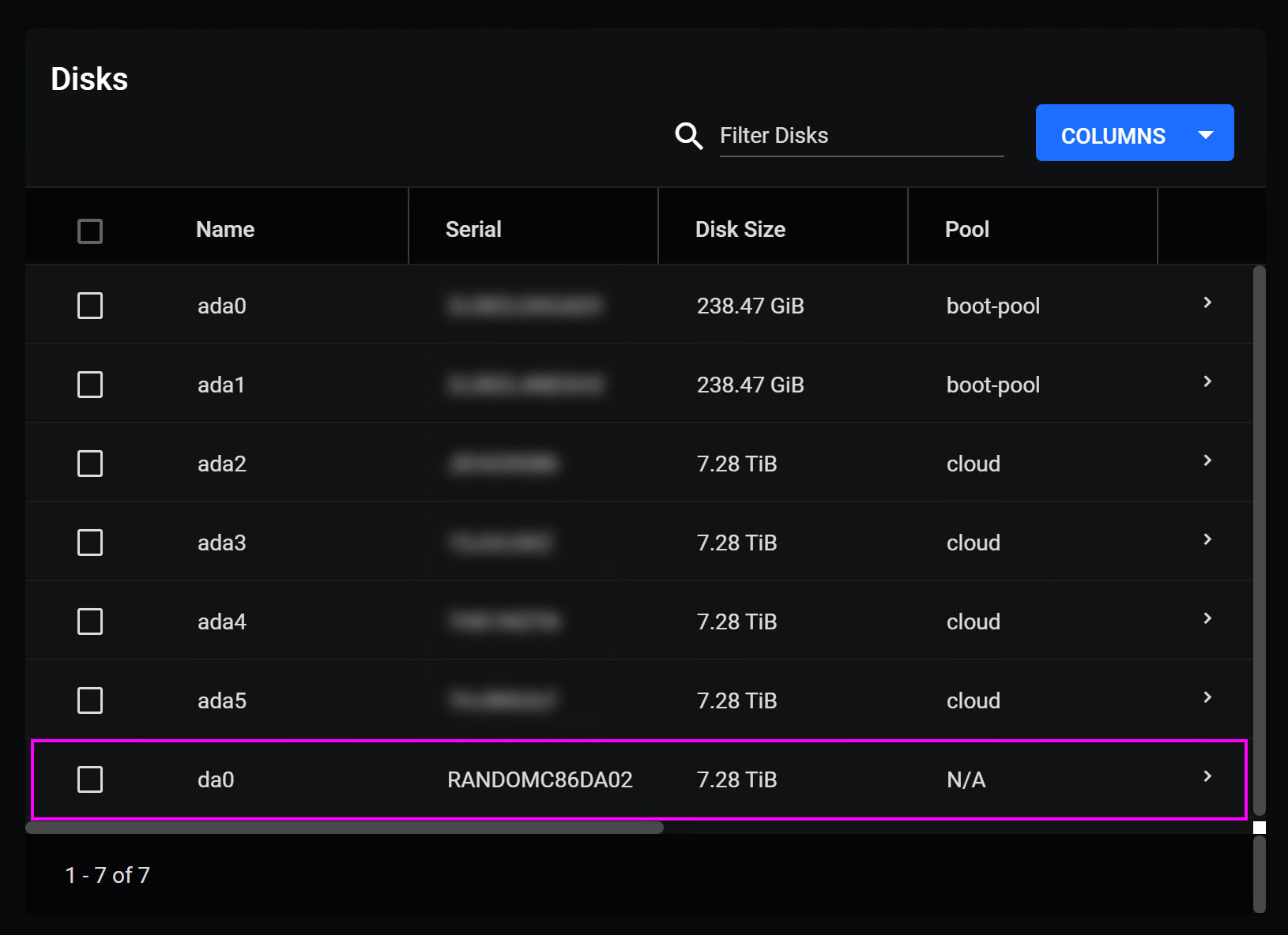

I connected an external drive to run SMART and then disconnected the disk while the system was shut down. TrueNAS still lists the disk, even after a reboot. The disk was never imported or added to pool.
I have searched the forums and google with no solution. What's the best way to purge the disk listing from the web GUI Disks view—or using shell?

Does it appear in camcontrol devlist?
abbott
Jun 6, 2021
6
No, here's the output...
root@disaster[~]# camcontrol devlist
<ADATA SU800NS38 02K0S86E>         at scbus0 target 0 lun 0 (pass0,ada0)
<ADATA SU800NS38 02K0S86E>         at scbus1 target 0 lun 0 (pass1,ada1)
<WDC WD80EMAZ-00WJTA0 83.H0A83>    at scbus10 target 0 lun 0 (pass2,ada2)
<WDC WD80EMAZ-00WJTA0 83.H0A83>    at scbus11 target 0 lun 0 (pass3,ada3)
<WDC WD80EMAZ-00WJTA0 83.H0A83>    at scbus12 target 0 lun 0 (pass4,ada4)
<WDC WD80EMAZ-00WJTA0 83.H0A83>    at scbus13 target 0 lun 0 (pass5,ada5)
<AHCI SGPIO Enclosure 2.00 0001>   at scbus16 target 0 lun 0 (pass6,ses0)
9,700
Looks like it's a bug then.
Report the problem from System | Support in the GUI.
There's probably a way to mess with the config DB manually to take it out, but it's not the kind of worm-can I want to open up.
