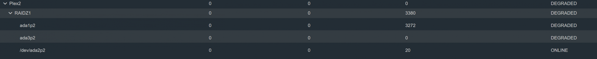

Sorry, I am a noob with FreeNas. I have a brand new pool that is showing Degraded. I'm not sure what drive is bad; ada1, ada2, or ada3. I did try and run the smartctl -t /dev/ada(1-3), but it did not return any results. The screen shot is the only results it returned (after about an hour of waiting for all 3.
Here is what my Pool status shows.
could it be possible that the drives have already gone bad after a couple of weeks?

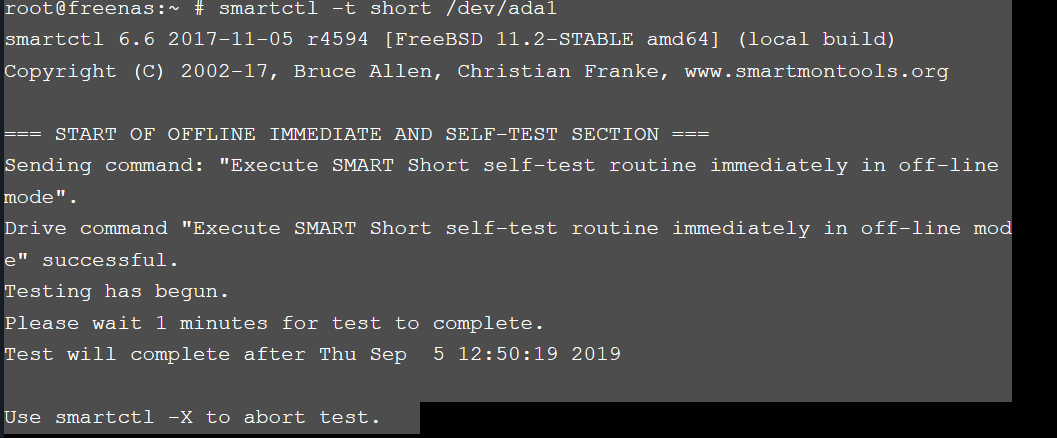

The smartctl command only runs the test; it doesn't tell you the results. Use smartctl -a /dev/ada1 and review the results. Ideally run this command via a remote shell (enable SSH from your Services panel, if you need a Windows client try PuTTy) so that the text can be pasted here inside of [ CODE ] blocks.
Given the zpool status though, you seem to have two degraded drives in a RAIDZ1. Data corruption is possible at this point, but you may have gotten lucky and the checksum errors on ada1 might have valid copies on ada2+3, and similarly the ada2 errors might be covered by ada1+3.
ST8000DM004
That's a shingled drive. Is this ada1 by any chance? Either way, strong suggestion to shuck another WD 8TB external and use it to replace.

Thank you @HoneyBadger ! I'm not sure what happened, but now, after a restart, all my folders/files are gone off that pool. Yes, the seagate is ada1.
Here is the code from the -a command for ada1.
[# smartctl -a /dev/ada1

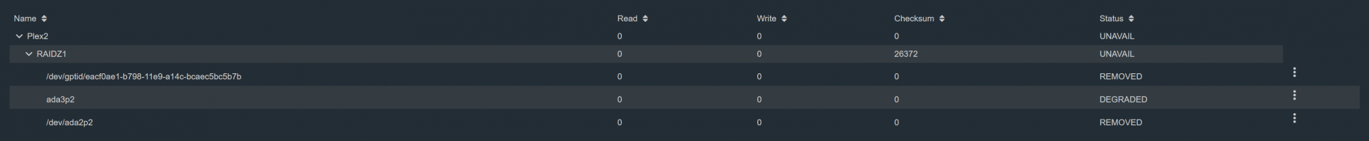

Pool Plex2 state is UNAVAIL: One or more devices are faulted in response to IO failures.
Fri, 06 Sep 2019 07:24:09 GMT
I have not removed any drive!

The drive known as ada1 is in very bad shape with almost half a million read and approaching 34 million seek errors. This drive is destined for the garbage.
It looks like ada2 may be in the same direction.
ada3 looks OK from that test, but since your pool is only RAIDZ1 that means with 2 disks out, your data is lost (I hope you have a backup of anything important).

Here is what I get back from -a on ada1, looks like ada2 is now ada1. So both WD drive look alright if I'm reading this right.
~ # smartctl -a /dev/ada1
smartctl 6.6 2017-11-05 r4594 [FreeBSD 11.2-STABLE amd64] (local build)
Copyright (C) 2002-17, Bruce Allen, Christian Franke, www.smartmontools.org
Device Model:     WDC WD80EMAZ-00WJTA0
Serial Number:    7HKJ05VF
LU WWN Device Id: 5 000cca 257f18d28
Firmware Version: 83.H0A83
User Capacity:    8,001,563,222,016 bytes [8.00 TB]
Sector Sizes:     512 bytes logical, 4096 bytes physical
Rotation Rate:    5400 rpm
Form Factor:      3.5 inches
Device is:        Not in smartctl database [for details use: -P showall]
ATA Version is:   ACS-2, ATA8-ACS T13/1699-D revision 4
SATA Version is:  SATA 3.2, 6.0 Gb/s (current: 6.0 Gb/s)
Local Time is:    Fri Sep  6 15:46:02 2019 PDT
SMART support is: Enabled
General SMART Values:
Offline data collection status:  (0x80) Offline data collection activity
                                        was never started.
Self-test execution status:      ( 245) Self-test routine in progress...
                                        50% of test remaining.
data collection:                (   93) seconds.
capabilities:                    (0x5b) SMART execute Offline immediate.
                                        command.
                                        Self-test supported.
                                        No Conveyance Self-test supported.
SMART capabilities:            (0x0003) Saves SMART data before entering
                                        power-saving mode.
Error logging capability:        (0x01) Error logging supported.
Short self-test routine
recommended polling time:        (   2) minutes.
Extended self-test routine
recommended polling time:        (1029) minutes.
SCT capabilities:              (0x003d) SCT Status supported.
                                        SCT Data Table supported.
  1 Raw_Read_Error_Rate     0x000b   100   100   016    Pre-fail  Always       -       0
  2 Throughput_Performance  0x0004   129   129   054    Old_age   Offline      -       112
  3 Spin_Up_Time            0x0007   253   253   024    Pre-fail  Always       -       286 (Average 48)
  4 Start_Stop_Count        0x0012   100   100   000    Old_age   Always       -       325
  5 Reallocated_Sector_Ct   0x0033   100   100   005    Pre-fail  Always       -       0
  7 Seek_Error_Rate         0x000a   100   100   067    Old_age   Always       -       0
  8 Seek_Time_Performance   0x0004   128   128   020    Old_age   Offline      -       18
  9 Power_On_Hours          0x0012   100   100   000    Old_age   Always       -       769
10 Spin_Retry_Count        0x0012   100   100   060    Old_age   Always       -       0
12 Power_Cycle_Count       0x0032   100   100   000    Old_age   Always       -       325
22 Unknown_Attribute       0x0023   100   100   025    Pre-fail  Always       -       100
192 Power-Off_Retract_Count 0x0032   100   100   000    Old_age   Always       -       839
193 Load_Cycle_Count        0x0012   100   100   000    Old_age   Always       -       839
194 Temperature_Celsius     0x0002   216   216   000    Old_age   Always       -       30 (Min/Max 24/35)
196 Reallocated_Event_Count 0x0032   100   100   000    Old_age   Always       -       0
197 Current_Pending_Sector  0x0022   100   100   000    Old_age   Always       -       0
198 Offline_Uncorrectable   0x0008   100   100   000    Old_age   Offline      -       0
199 UDMA_CRC_Error_Count    0x000a   200   200   000    Old_age   Always       -       0
SMART Error Log Version: 1
No Errors Logged
# 1  Short offline       Completed without error       00%       720         -
# 2  Short offline       Completed without error       00%       720         -
9,700
Both of the WD drives data you shared show no areas of concern (other than only recording short tests... no long test to be sure of health).
