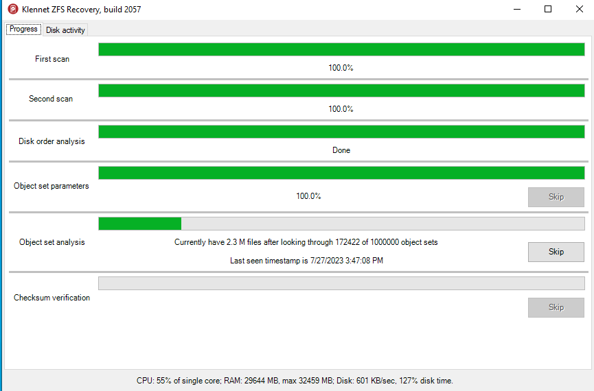

Hey folks, some cautiously optimistic news here - it seems like Klennet is seeing files so far. I'm still waiting on it to work through the last few of its steps, so I'll update again once it has finished processing. Unfortunately I'm moving in a week so I think I'm going to have to wait until I get to the other side to actually recover the data, but signs seem good at the moment...
@Heracles I'm sure you'll be delighted to know that my new pool is raidz-2, the machine still has ECC, and the pool is scrubbed weekly. I'll be sure to set up some SMART online tests monthly or something.
