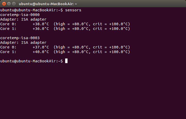

Why haven't you used an operating system to check your CPU temps? Sysctl -a | grep -i temperature
I'm a noob unfortunately. The temps listed are after 1.5 hours of usage.
Ignore the MacBookAir thing. I booted from a persistent USB install of Ubuntu so I didn't have to wait.
