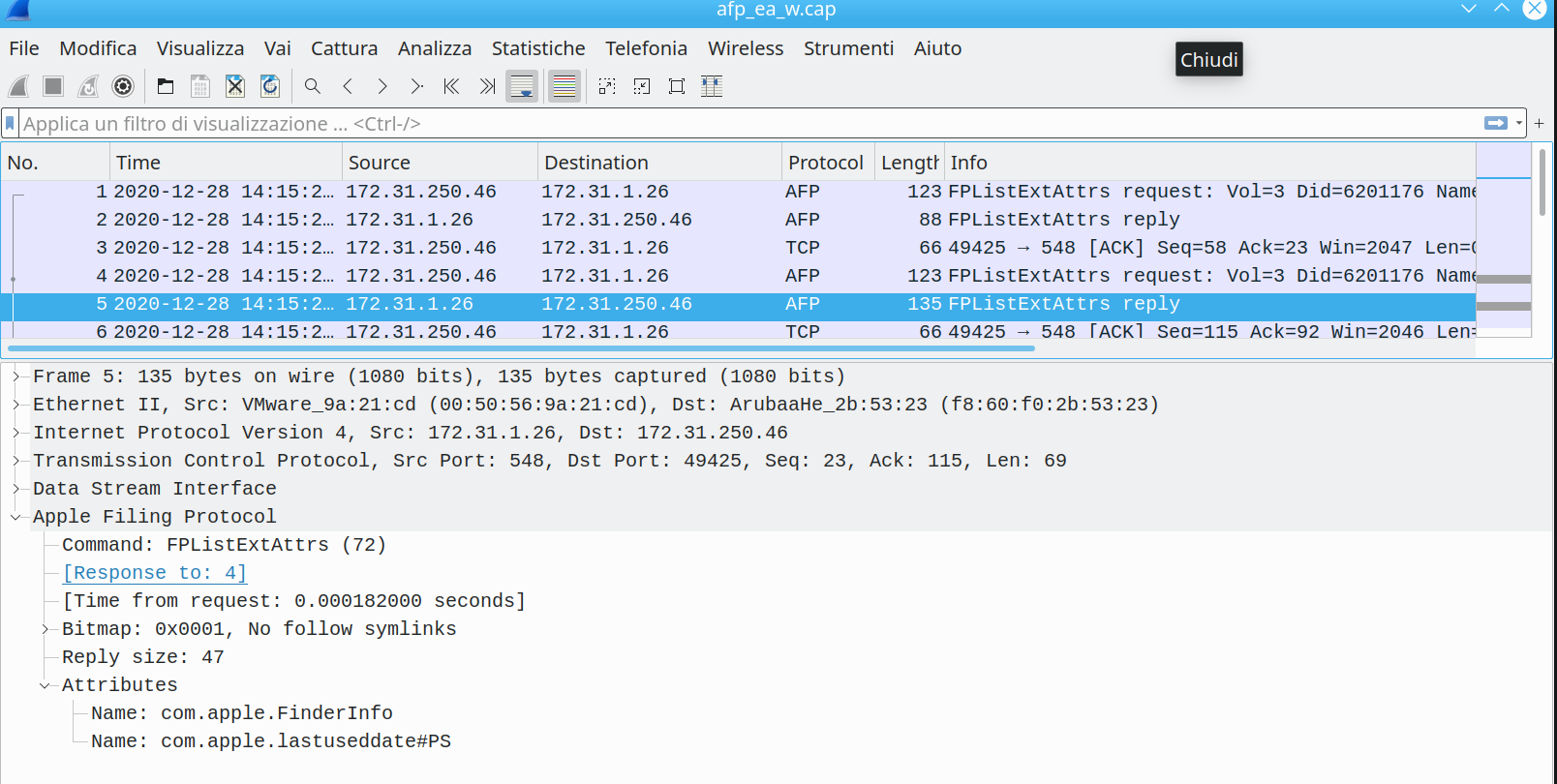

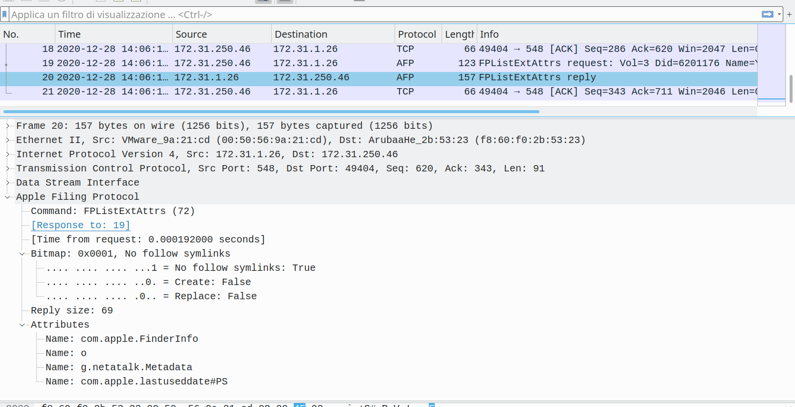

giox069
Jun 1, 2012
28
Thank you for the suggestion. I can send you the full .cap file via private message if you need.
In any case, see in the following screenshot what I discovered capturing on freenas and then opening with wireshark:
1st xattr request to .pdf file
And then, after a stupid ls on topdir, it starts working. This is the same xattr command as the 1st attempt, but now works.
I suppose org.netatalk.Metadata is hidden by netatalk and not returned on the wire to MacOS when recognized, right?
anodos
Sambassador
Mar 6, 2014
9,553
I do not believe org.netatalk.Metadata should be visible when listing xattrs. It's an internal xattr used by netatalk to store certain AFP (FinderInfo, AFP Flags, Comment, CNID). Do the affected files perhaps have an appledouble file associated with them (as well as the xattr)?
