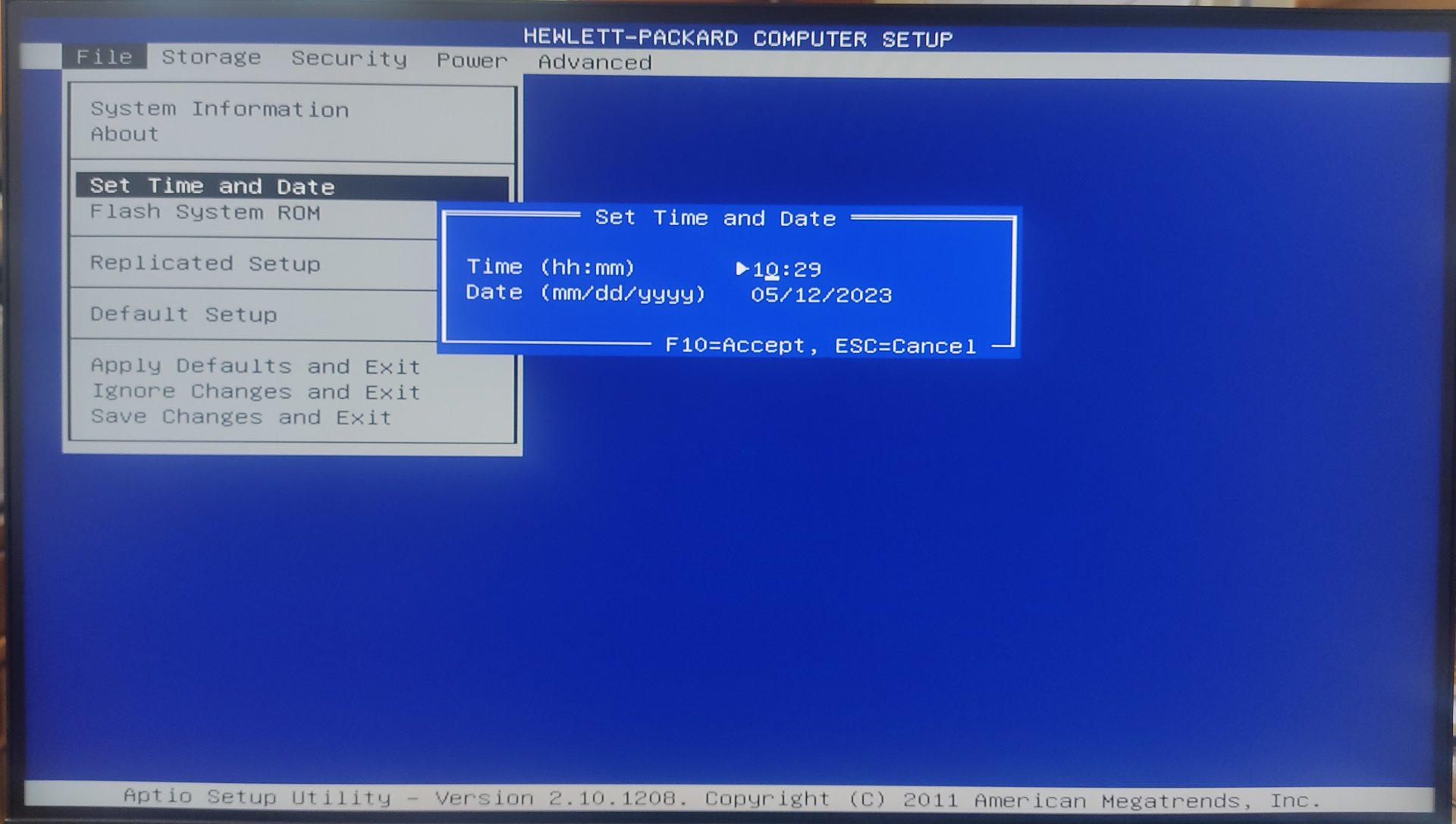

Good day everyone, install Trunas Core perfectly and everything is fine.Until the BIOS battery was exhausted, it was changed, then the BIOS time was desynchronized from the system one.
I adjust the system time and the BIOS time is misadjusted and I need both times to be synchronized since I have configured the server to turn on automatically at one time.

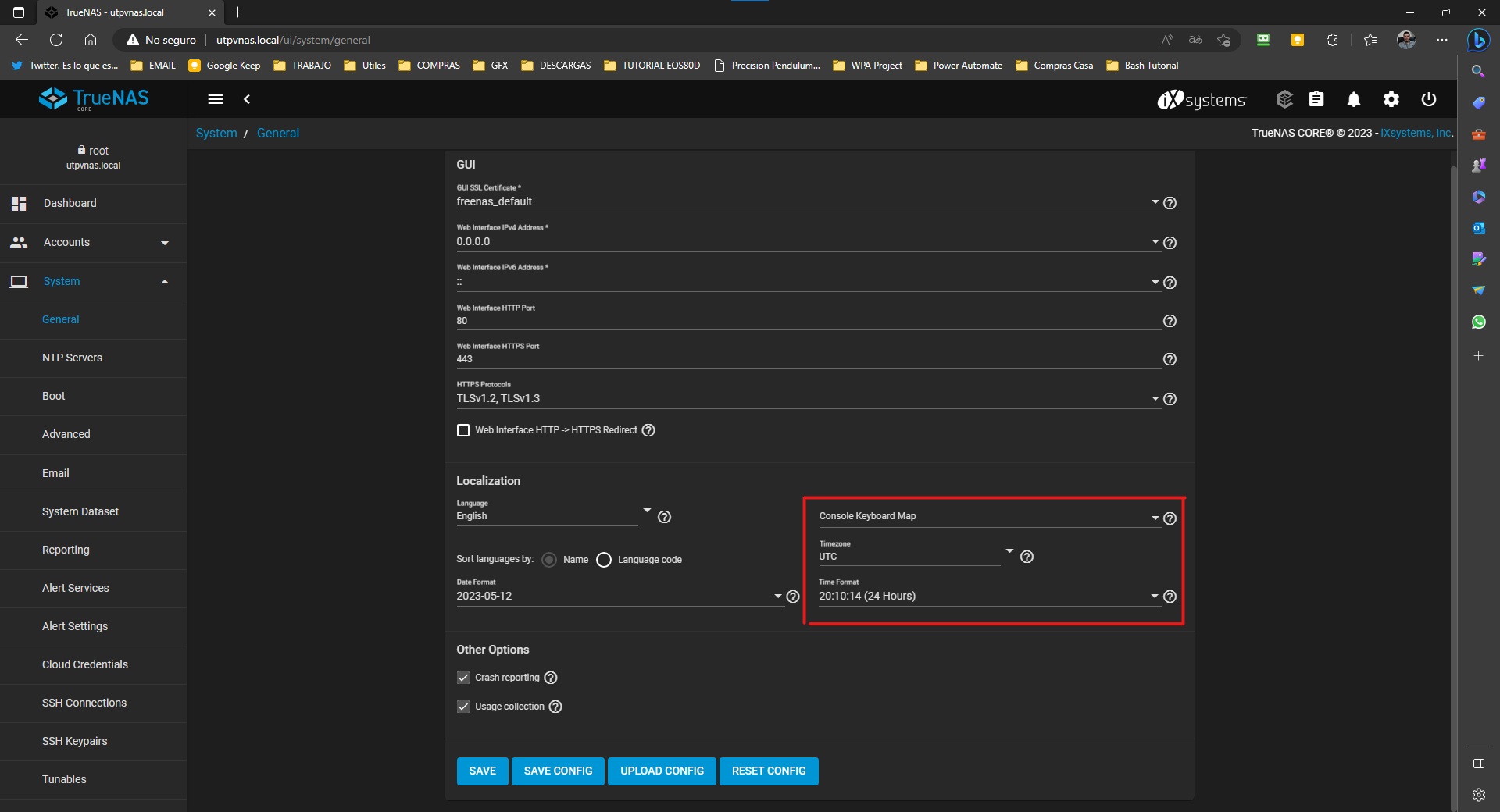

I put the time zone in America/Panama, the time displayed by the WebUI is correct, but when I run the command: date, the time does not correspond.

Find the optionIn the BIOS to change the time zone, but you don't have that option. It's an old bios.

I don't see in the BIOS where to change the time to UTC.
I put the correct time in the BIOS but when I run the date command there is 4 hours difference.

I did, but if you see in the screenshot the time does not correspond to the one shown in the WebUI. There is 5 hours difference
The time of the date command is correct with the BIOS.

What I do not understand because if I already have the time of the BIOS synchronized with the kernel.
Why does the wrong time keep appearing in the WebUI?

The settings you've boxed in red are for the time FORMAT. While this usually also shows the current time, I suggest trying a reboot after setting your timezone to whatever your local timezone is (sorry I don't know offhand). Then I suggest a quick reboot to see if things make more sense.
