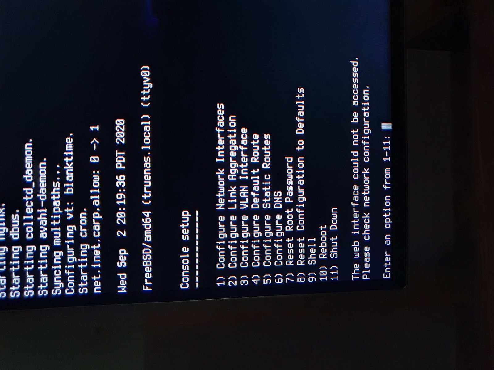

Hello Everyone,

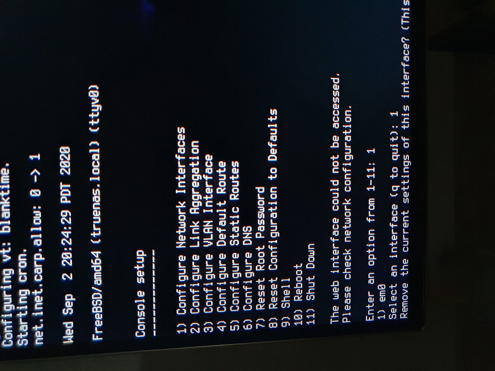

on the first time boot I have this message:

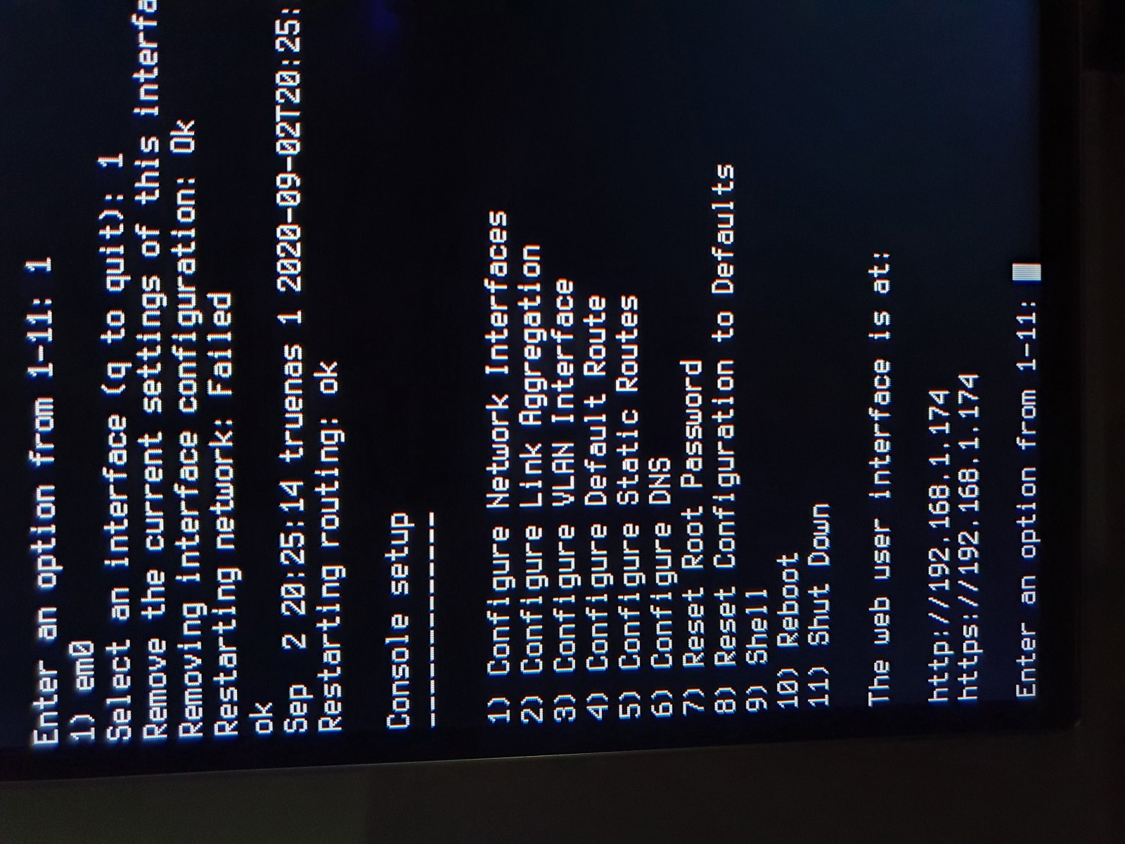

for being able to have a network connection, I select option 1:
and finaly obtain an ip adress:
But if I reboot my machine, those settings are lost. Is it a way to save it?
Many thanks

After you have configured the IP-address, try to log into the GUI, configure the address via GUI again. Maybe this way it stays persistent.
Next time you post pictures, please rotate them to correct orientation before posting them, thanks.

did I understand you right? I must configure a static IP adresse and then configure it again via GUI.
Fredda
Jul 9, 2019
608
I would not say this is a must. IMHO the network config should survive a reboot if it is configured via the console.
But that is a thing I'd try.
