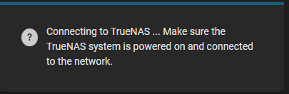

Connecting to TrueNAS ... After creating or starting jail
yusisushi
Nov 11, 2022
14
Every time I either start or create a jail this happens, about 30seconds later the webUI stops responding and it will stay like this forever until I reboot:
I read multiple posts about this but nothing resolved it for me.

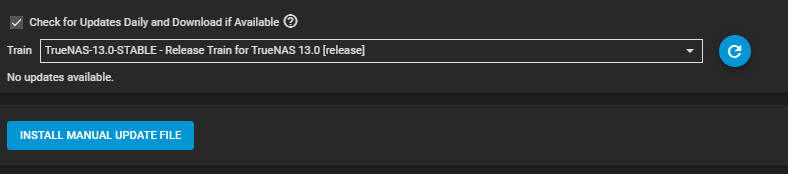

  2. I already updated to the latest version
    cat /etc/os-release...
    VERSION="13.1-RELEASE-p7

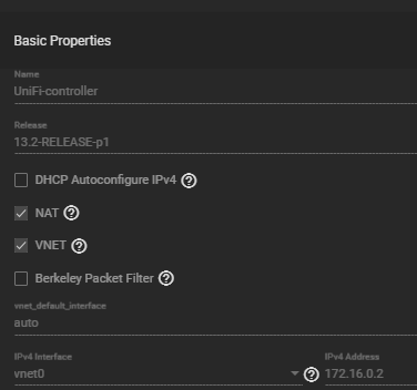

Is it NAT or VNET?
Hi, sorry for not clarifying earlier. It appears both;
Now I've done some additional testing and the issue does not seem to happen with any jail except the template Jail I created.
I tried creating this jail both as a clone or basejail, both times with NAT and VNET option.
Notable: when the UI of TrueNAS becomes unavailable, the webinterface of my jails stay reachable.

What if you only take the VNET option? does the jail still block the UI?

If that jail never starts, I would suggest deleting it so you can't cause the problem anymore.
I'm a little bothered to not see a bridge interface auto-created when the jail starts if VNET is properly set up.
I also not you're using a Realtek NIC... https://www.truenas.com/community/resources/is-my-realtek-ethernet-really-that-bad.196/
Are your other jails using VNET?
Hi
Sorry for the late reply, all of my jails use VNET and NAT.
For my networkcard, it is the integrated NIC of the motherboard, and due to space constraints I have few other options.
