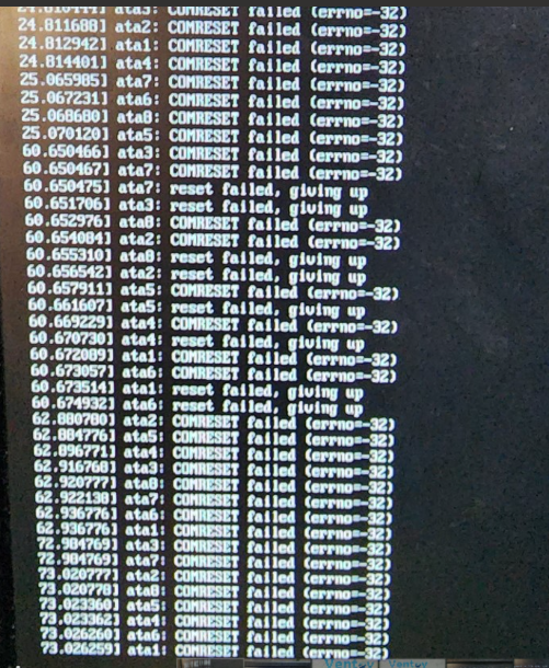

I am trying to install TrueNAS Scale 22.12.3.3 on a Supermicro X10DRU-i+ server plugging into the internal usb port on the motherboard or external usb.
When I boot up from usb I get the comreset failed (errno=-32) message and the install fails.
I have tried another usb stick using both Rufus and Venoy and still end up with the same result.
Any ideas or suggestion will be much appreicated.
Those errors are clearly related to SATA disks, hence the ataN device names. Disconnect all non-boot media and tell us the details of your system in terms of storage.
I removed all 12 SAS disks leaving behind just the Sata SSD on which I previously installed Truenas Core and the bootable USB. Still the same results.
SAS disks? The errors are for (S)ATA disks. And you're getting the same errors, for multiple disks, even though there are no such disks attached?
After waiting for a bit longer I was able to continue with the installation and it worked fine. I have no idea what was wrong as I am new to this.
