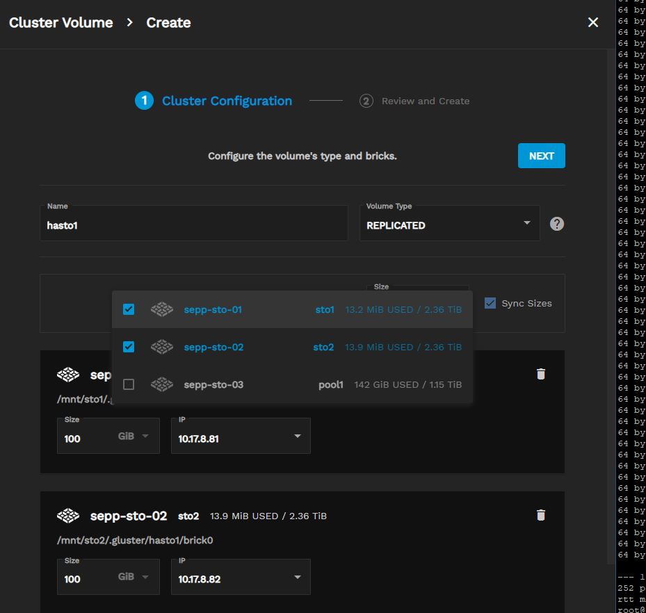

Hi, I am in the phase of first time testing/crating a cluster volume.
I Have one that is already active (03) and two freshly installed ones.
When it comes to cluster selection I am not able to select all 3 nodes, I can select the new installed ones 1 and 2, then 3 is grayed out, or if I select 3, 1 and 2 are grayed out.
On 1 and 2 are just empty pools, on 3 are already some datasets and apps. Why can't I select all 3, do they need to have the same size, datasets,...?

Hi, yes RC2 and TrueCommand I treid vrom docker hub latest and nightly.
Yes, dispersed would also be fine, in the end I would like to create a distributed dispersed cluster, but now I am just testing.
But main question is why I can only select 1 + 2 or only 3? As soon I check 1 or 2, 3 is grayed out. When I select 3 1 and 2 are grayed out.
1 and 2 have a pool with equal size and the pools are empty, on 3 is a smaller pool that has already some datasets with a little data on it.
I thought I can now simply create a smaller gluster on all 3 as the brick is located on the pool but I am not able to select all 3 via gui.
Br

Sure, I tried all options, it is always the same behavior.
All nodes have static IPs and all are synced to an NTP server. All node IPs and also TC are in the same subnet.
TC is running as docker on n3 with own network on the same bridge as the mgmt ip of n3.
On node 3 I was already testing basic functionality, so this node has one pool1, with several ds on it and also some docker containers running.
Here I had to change on all 3 the Kubernetes cluster CIDR, service CIDR and cluster DNS IP as it conflicted with our local NTP. (just in case this could be relevant).
The nodes, 1 + 2 are fresh installs with only a empty pool created on them.
I was able to add all 3 nodes to TC without any problems. And tried then to create a cluster, which fails already as I cant select the nodes.

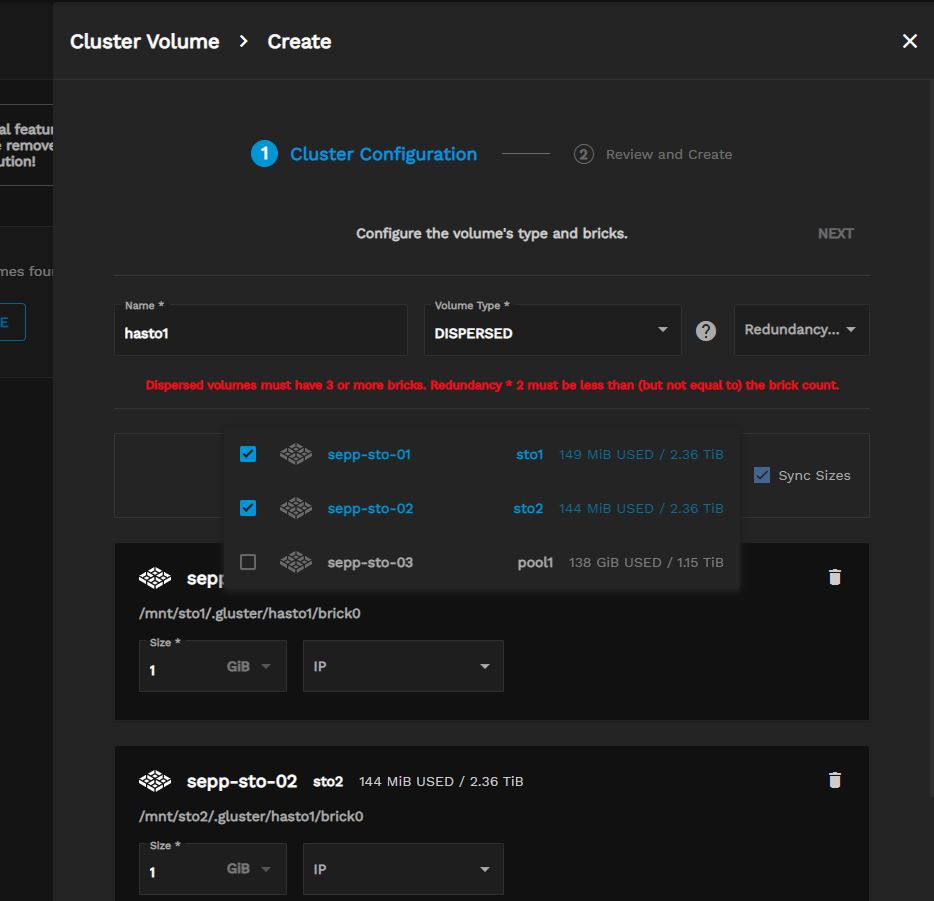

Hi, same problem here:
TrueNAS-SCALE-22.02.0.1 (3 nodes) and truecommand 2.1.1 System Version 2.1.1-20220329 Middleware Version
Newly installed, created ZFS pools on the nodes.
Tried to create a cluster from Truecommand, and pools from node 3 are not selectable together with nodes 1&2.
Also tried to delete and re-add node3, without any success.
If I try gluster command from truenas node1, the volume gets created, truecommand seems to see it but the cluster dashboard keeps hanging.
Hope there's a solution.

Ok, I moved the system pool to boot-pool on all the nodes, restarted the nodes.
Now it's node1 that is not selectable together with the other nodes...
There's something strange happening, is there a way to debug this?
Thanks.
Urbaman
Jan 8, 2022
29
Also tried:
- remove all nodes from truecommand
- restart nodes and truecommand
- add nodes to truecommand
Still, node1 pools not selectable in cluster creation.

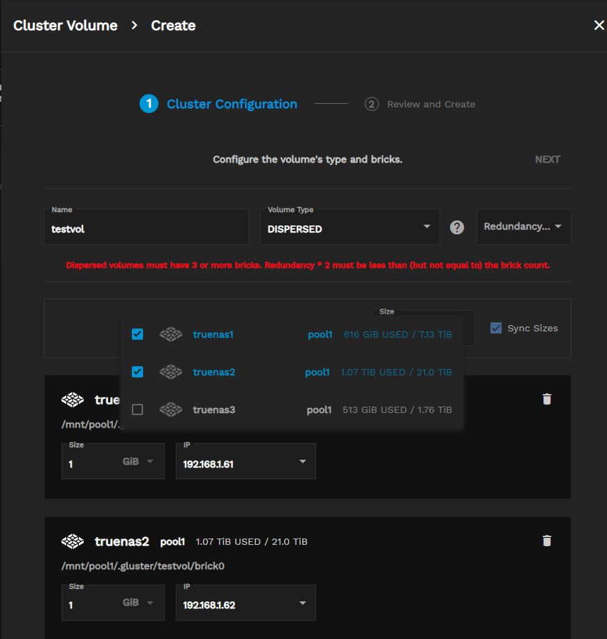

Same same over here;
2.1.1
System Version
2.1.1-20220329
Middleware Version

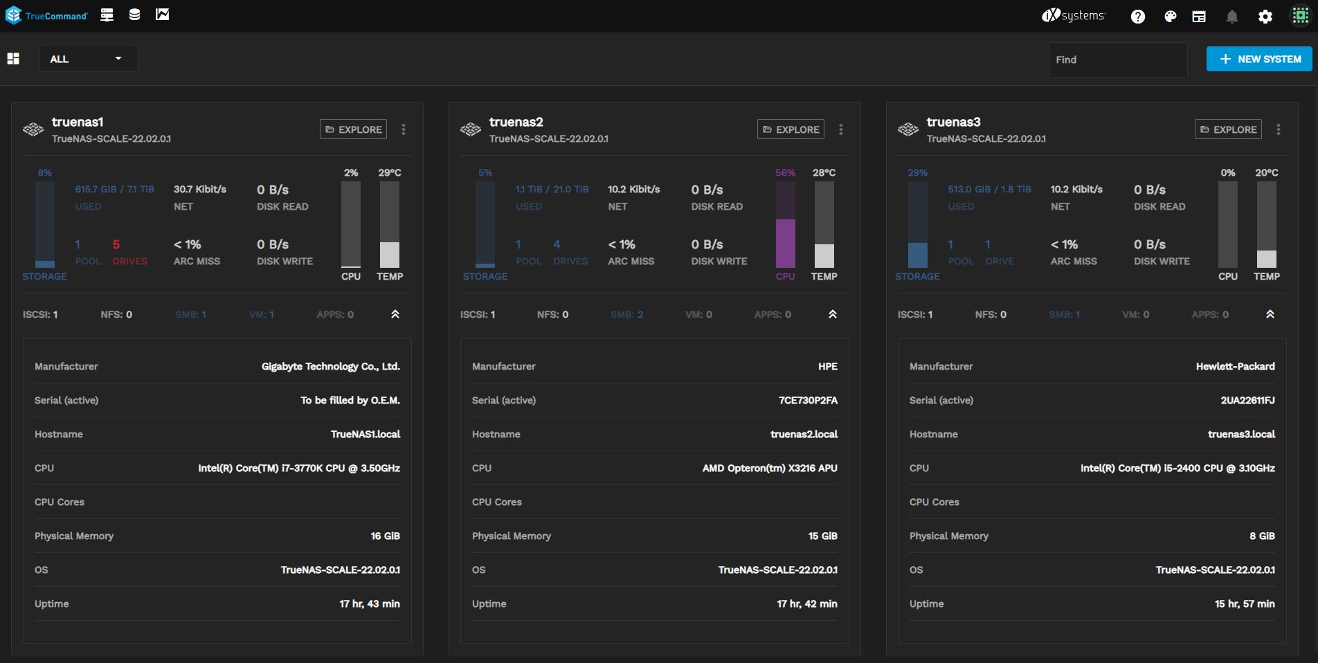

Created nas1 and 2 a few days ago, added 3 to the network yesterday to play with clustering only to be denied adding it as a 3rd brick. I can select 1&2 or 3 but never all 3 regardless of selection order.
Cheers,
JR

Gave this a try, no go, removed all 3 nodes and reentered, let me select 3 nodes for bricks but wouldn't let me click next.
