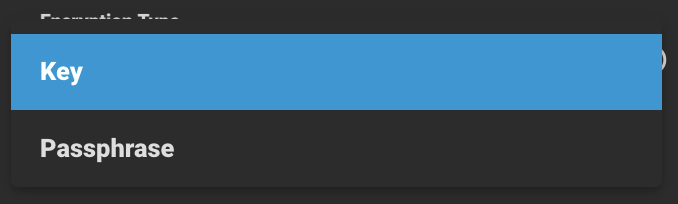

Can't he just change the encryption type from key to passphrase under Storage > click the three does next to the dataset/pool > encryption options? The same goes for the child datasets, click "inherit encryption properties from parent".

Well, this is weird. I was expecting an option to select the encryption type, like a drop down. Was searching really hard exactly where you, irTwit, said. Couldn’t find it. I just checked again an…there it is.
Don’t remember which dataset I tried to change, maybe it was a special one…or the UI design just isn’t for me ;)

I've had the encryption type drop down disappear on me as well. What seems to bring it back is to export the pool and then reimport it. The drop down will appear if that's the first thing you access for the particular dataset/zvol.

Yes, you can change to passphrase from the menu. I just did it, and it worked fine. Rebooted and it prompted for passphrase, all good.

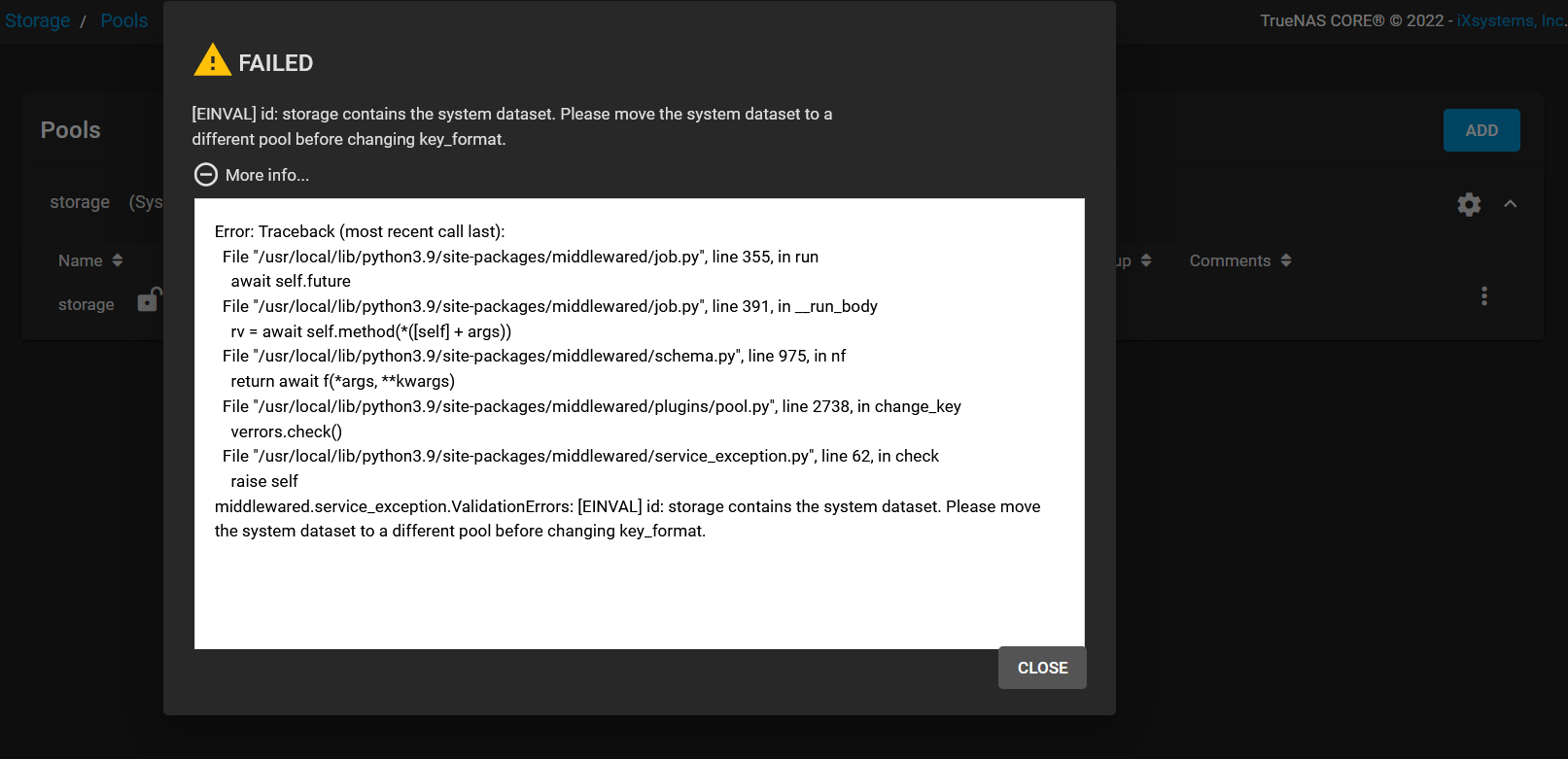

hello,
i created a pool with encryption but after creation i cant change keys to passphrase...

400
Have you tried doing what the error message asks you to do to proceed?
no,
i thought there is an option while creating new pool to even select passphrase or key... apparently its not there? question would be why ... bug?

@neofusion i wanted to change encryption key of the pool to passphrase - its not possible.
I can destroy pool and re-create new one - but while create new pool and selecting Encryption there is no option for a passphrase only key is generated.

The error message you posted literally tells you what needs to be done to solve the core problem (system dataset has to be moved first).
Destroying the current pool and making a new one is not it.
apparently i do not understand that message ...
whats system dataset and how can i move dataset to other pool as there is only one pool.... ie storage.
to be moved where? i dont get it.
edit2 so can i move system dataset to boot-pool?
thanks

The system dataset cannot be on a pool that is encrypted with a passphrase. Since you want to change the encryption, the system is making sure that the system dataset is moved somewhere accessible first.
Here is the manual describing it, it also shows you where to find the setting in the Core menu: https://www.truenas.com/docs/core/uireference/system/systemdataset/
You should be able to move it to your boot-pool. Depending on the hardware you can keep it there. Not recommended if you're running it on something unsupported like on usb flash memory though.

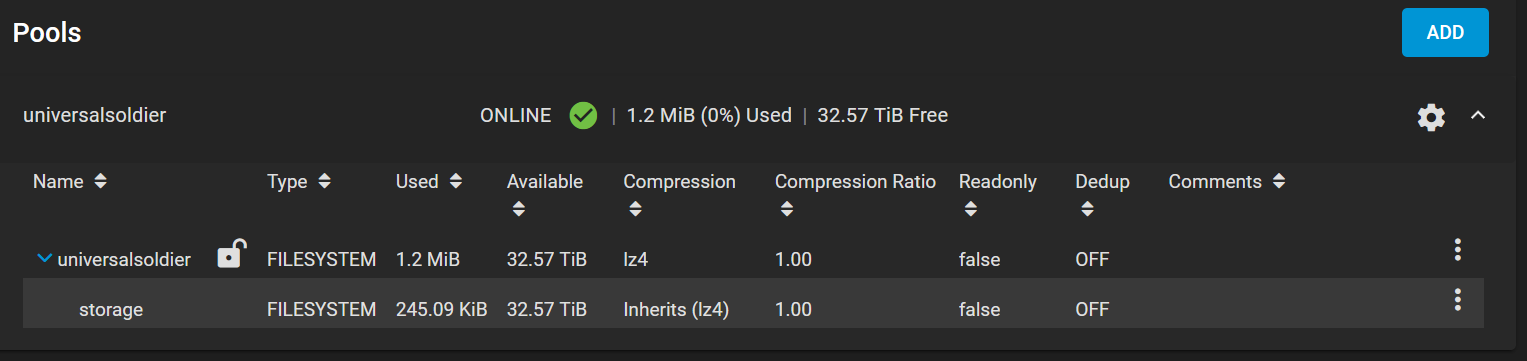

on top of the 3.5' drives i created z1 pool and set encryption as following
not sure whats setup its better... like that that pool is encrypted with passphase and dataset storage inherited it...
or to create
main pool encrypted with the key
and inside create dataset storage without inherited encryption with key - and set encryption on it via passphase...
thx

well i moved system dataset to boot-pool which sits on the nvme drive.
or to create
thx
The second option is more flexible since it lets you choose if any single dataset should use no, passphrase or key-based encryption.
Encrypting the entire pool with a passphrase is more secure, but also less flexible because it means that you cannot access anything at all on the pool without manually unlocking it after a reboot. Sometimes that security is desirable, sometimes it is more of a chore; it depends on your usage and perceived threat.
