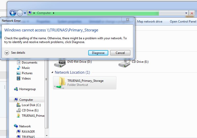

Okay, my desktop computer running windows 11 is now talking to the NAS. I don't know what I changed, but it's now talking. But my laptop running windows 7 is still refusing to connect to the NAS. I unplugged and restarted and plugged back in just about everything half a dozen times.
Is there any quick way to get rid of all network information on windows 7 so I can set all my networks back up from scratch? I guess I can always reformat my laptop and reinstall windows 7 on it. :tongue:

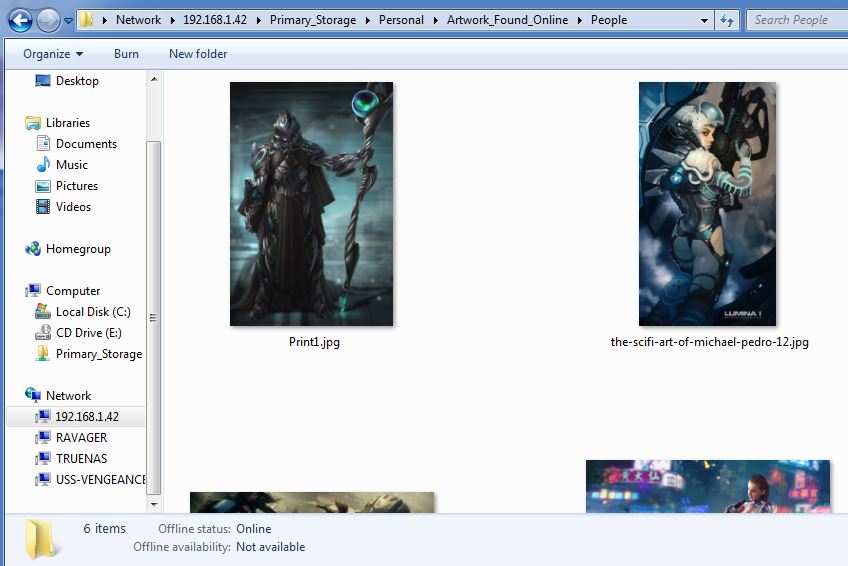

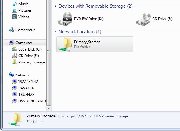

Okay, I typed in the \\192.168.1.42\Primary_Storage into the address for adding a network location.
I've still got a dead ghost of TRUENAS network location, but it's working!
