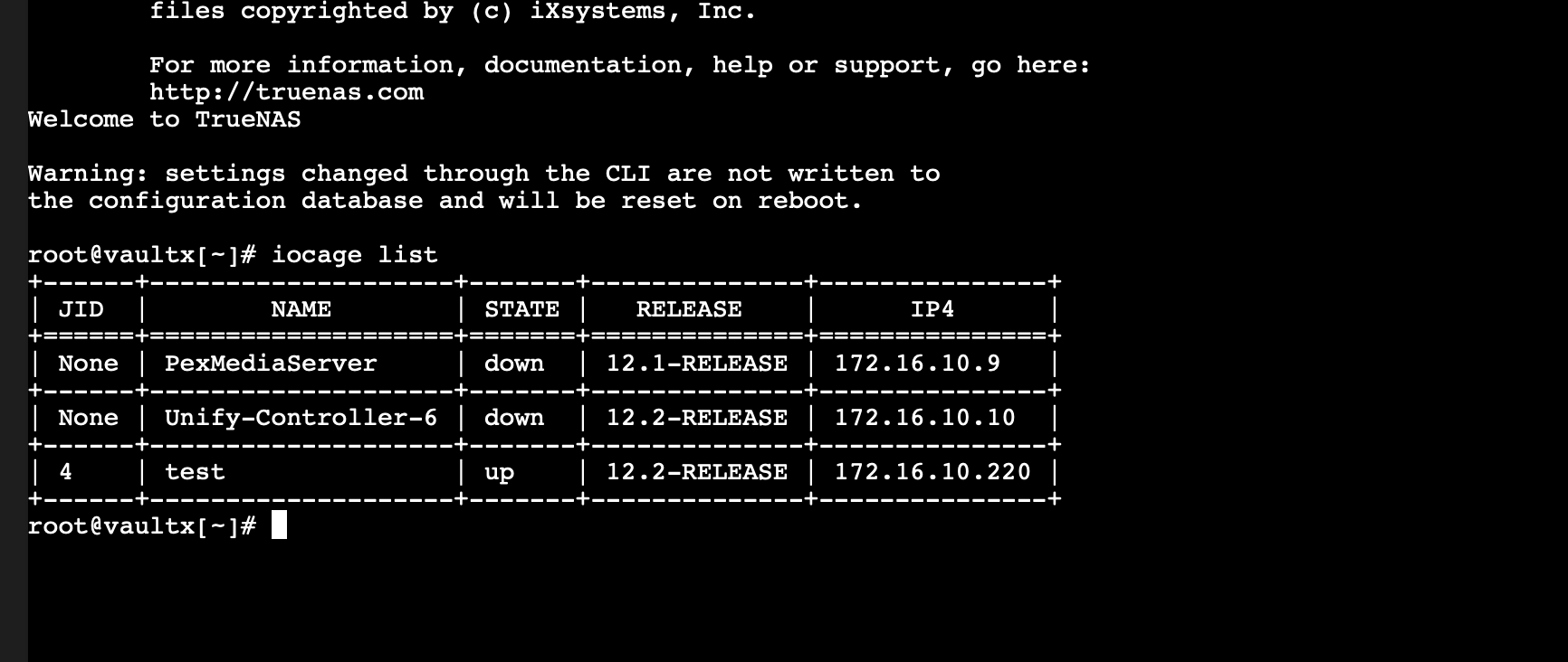

ok... see problems...
I created a temporary jail, to test if that created a vnet, yes it did, and it assigned the required IP.
the comment about can not edit settings, was mis leading, i was referring to the my 3 "problem" jails, the 4th one, the test one I know I can't edit while running.

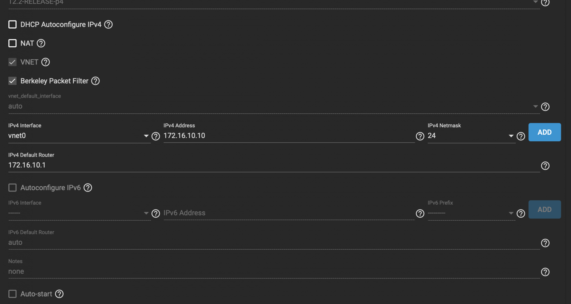

I've been able to tick untick tick boxes, in the end I got a vnet0 selected... (looks like it was created after I created the test jail) and then assign the ip, subnet and gw... but when i click start it fails, see below.
G

I can't see which jail the first screenshot is from, but it seems BPF and VNET are set there.
if you can post the output from iocage get all Unifi-Controller-6 we may be able to spot the problem.

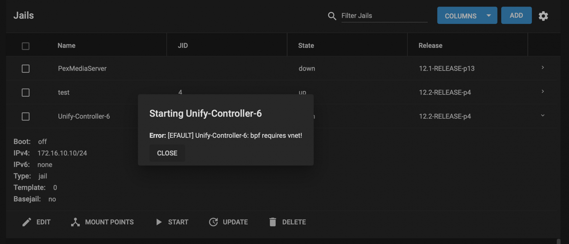

OK, so with no DHCP, you shouldn't need bpf, which should eliminate that error.
georgelza
Feb 24, 2021
417
removed bpf

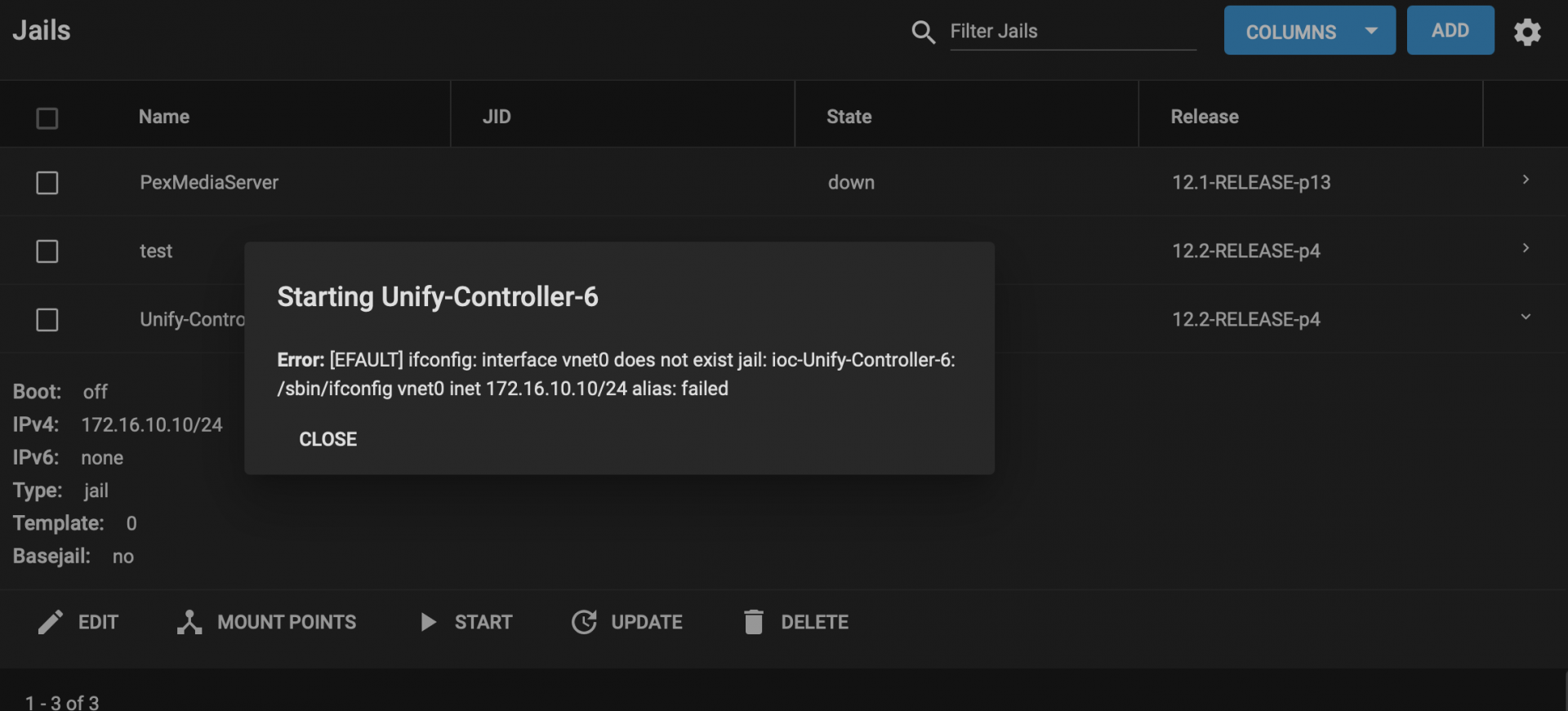

tried to start, error received back.
G
9,700
OK, then let's have a look at that...
ifconfig from the host

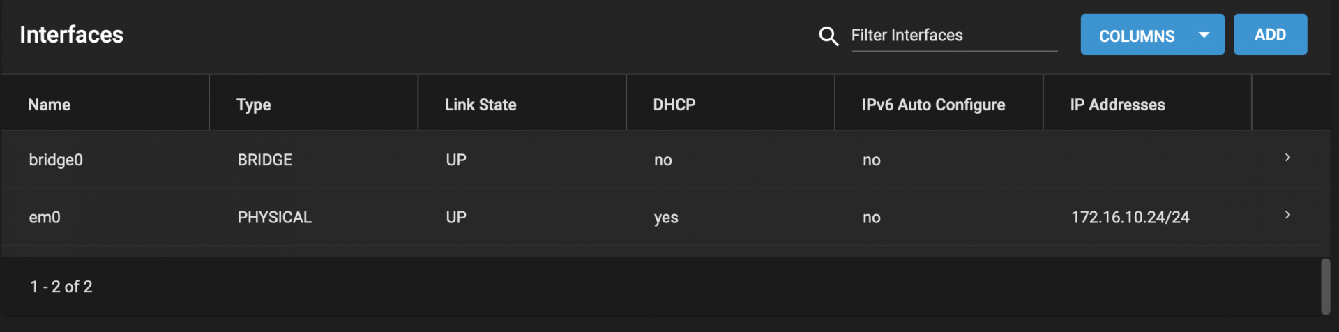

Also I see you have vnet set to 0 on the jail (and it should probably be 1 instead)
9,700
I don't see where your em0 is a member of the bridge together with the VNET. Is that intentional? (are you trying to keep your jails from connecting out of the host?)

9,700
You can fix that (temporarily) by using ifconfig bridge0 addm em0 up
georgelza
Feb 24, 2021
417
I redid the bridge quickly
promised I did select em0 as a member to the bridge, when I created originally.
see below
