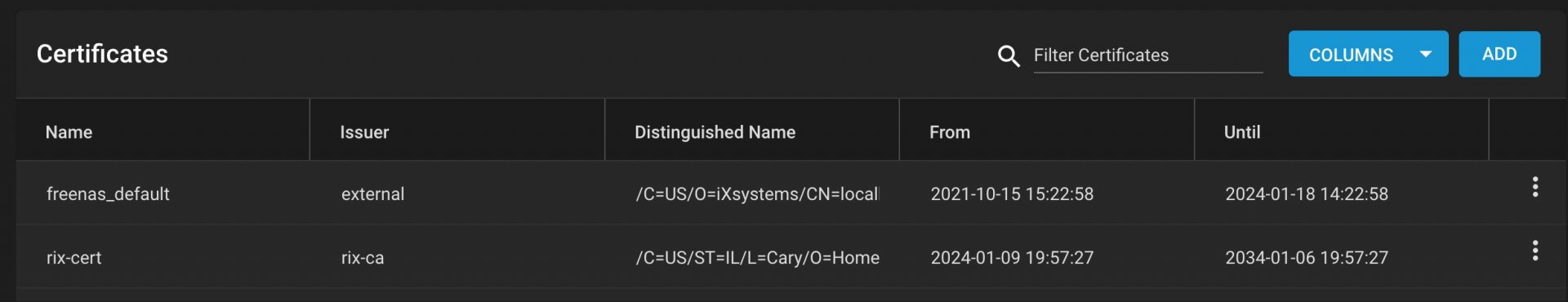

I am getting this warning now in TrueNAS v13.0 U6.0.
"Certificate 'freenas_default' is expiring within 9 days"
I see fixes for FreeNAS v11 but nothing newer. Trying to follow these instructions.
www.truenas.com
I think I have an internal certificate described. Though maybe it's incorrect...
But can't delete the freenas_default.

Durandel had this problem in the link above and fixed it by "... just changing the certificate the web interface was using."
I have no clue how that's done.
Are there other places I need to move pointers from the old cert?
Do you have to reboot to get the new certificate to go active?
Will I be locked out if I messed up the certificate and delete the old one?
