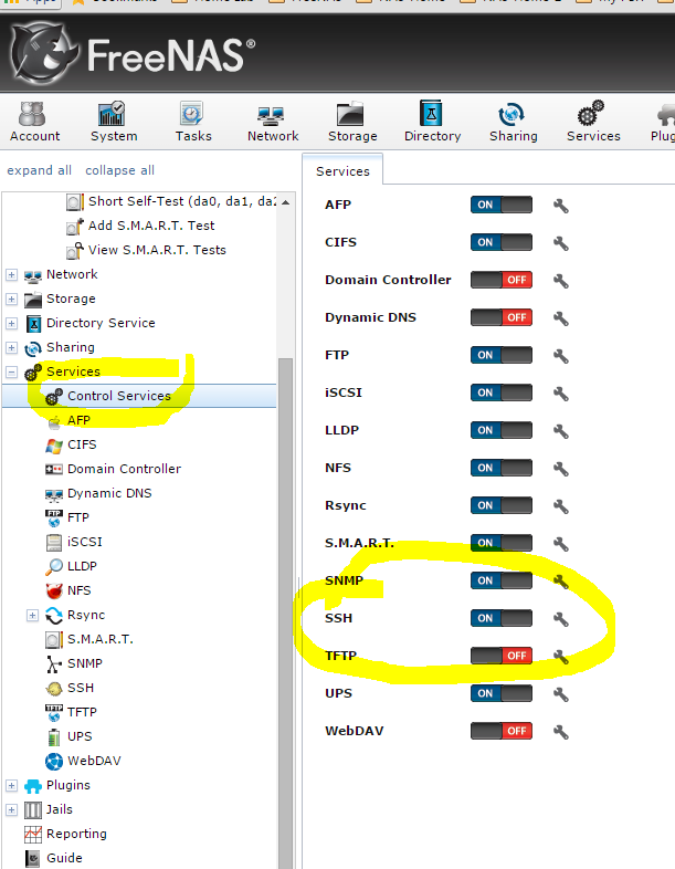

my apologies but is ssh enabled right out of the box? I was actually just trying to install it and configure it so then I can use putty from now on.
Just enable the SSH service:

Just remembered that a few mins ago lol Thank you. Im getting the hang of it.
