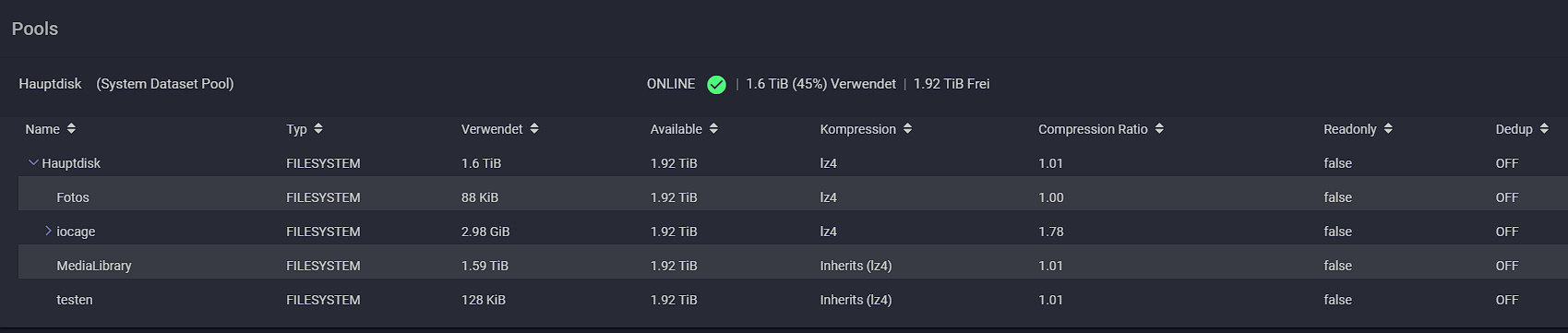

this is my dataset.
I need to connect to the Medialibrary. there is everything i need.
Where can i see wheter it is Child Dataset?

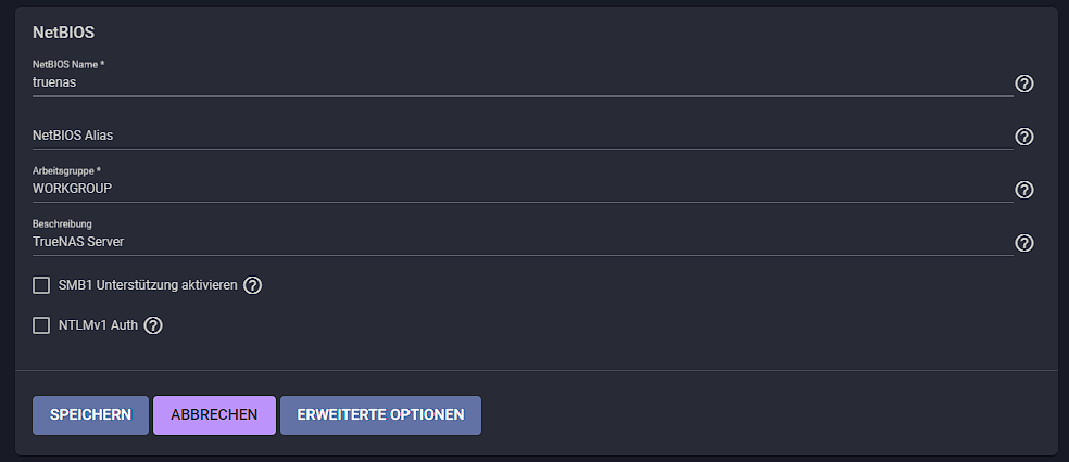

Here is the setup of my SMB Service. Must something be checked?
I would think you need to check the SMB1 and NTLMv1 options, but I have no experience with it.
I just know I have some old Windows XP equipment which are no longer accessible from my Windows 11 PC without enabling the SAMBA service.
