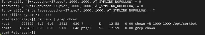

I trying install Nginx Proxy Manager, but can't. Installation always freezes on "Deploying". If check process list, i see chown in uninterruptible sleep (D) state.
Trying strace them shows that it takes about 200ms to set permissions for one file/folder. After some time (~2-3 min), chown is killed by someone and relaunched from start.

I rechecked now - i see changing permissions for /opt/certbot, but it don't mounted into container:
admin@storage[~]$ sudo docker inspect 3144d35316a3 | jq ".[0].Config.Volumes"
  "/data": {},
  "/etc/letsencrypt": {}
admin@storage[~]$ ps -aux | grep "chown"
root     3495918  0.2  0.0   2412   884 ?        D    12:09   0:00 chown -R 1000:1000 /opt/certbot

strace continue executes too much time.
After 10 minutes, it will be killed by someone, and restarted:
