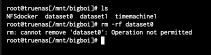

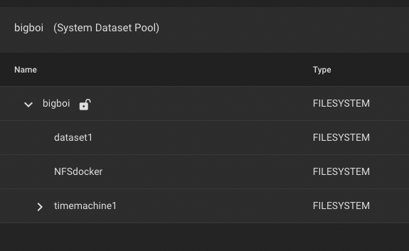

Hi!
I started making a zfs send recv from one dataset to another in the same pool, to remove dedup. I had to stop it and now I have a folder with the name of the new dataset in the /mnt/pool/newdataset but it doesn't show on the storage GUI.
I can't create a dataset with the same name, and I can't delete from the shell terminal as root.
What can I do to clean it up?

ZFS won't allow rm to remove datasets, even partial ones. Use zfs destroy bigboi/dataset0 instead.
I tried that too... :(
It says that the dataset doens't exist when trying to destroy it. But it says it exists when trying to create one with the same name, weird

I checked and there wasn't any snapshot on the "destionation dataset" that I wanted to delete. There was one on the "origin dataset" as that's needed to do the zfs send command.
I didn't try to create a dataset using the CLI to be honest (i don't know if that's possible, I guess it is, I just have never done it). The GUI gave me an error, it's the pastebin i posted in #8 when trying to create a new one with a different name. Seems like the pool is borked, I don't know the mecanism of how that happened...

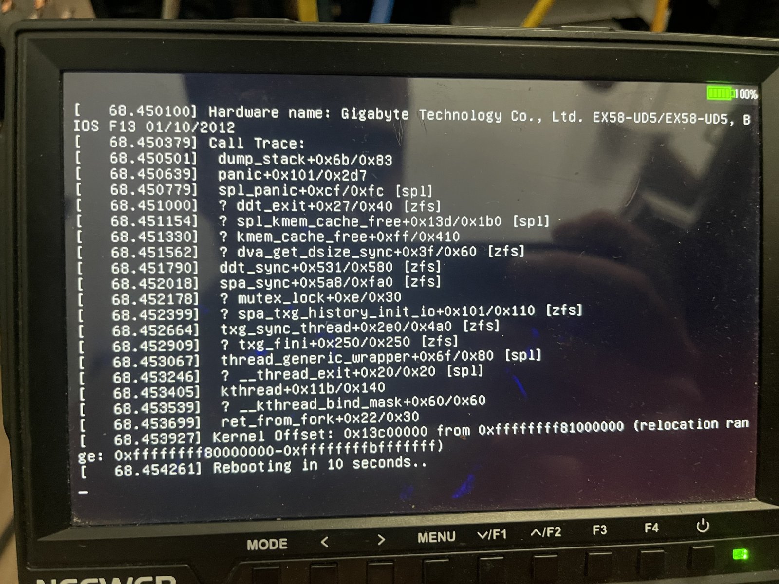

But now I even have a bigger problem. I have done anything else but the system rebooted and it's stuck in a bootloop. It starts loading truenas as usual but before ending I get this message:

Yeah, the boot loop is because it's trying to import the borked pool, and running into a circular reference. You'll have to pull all your pool disks to see if you can finish booting. If not, your boot pool also corrupted.

To update my situation.
I tried to install CORE instead of SCALE. Core installed fine but then first trying to boot it was trying to read the nfs pool that was present in the disk installed and got an error.
Surprisingly i tried to install Scale again, and for some reason scale doesnt seem to check if there is a pool when first booting I guess, as it booted just fine, with a default instalation. I tried to import the pool and it worked, but got the same error as in #8.
I deleted the pool and created a new one.
I tried to install Core again and this time worked, so its confirmed that there was a problem with the pool.
Im going to use Core now and restore my pool from backups to see if I get a more stable system.
