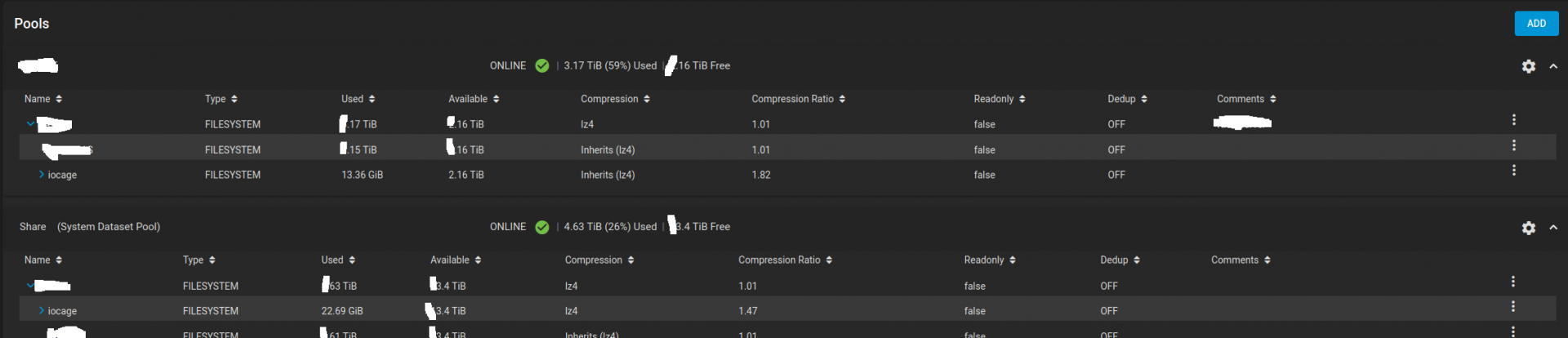

My old HHD is mounted correctly but when I try to mount on my linux machine I run into a permissions issue even though the pool for that HDD has the same permissions as my new homelab HDDs. I do not get it.

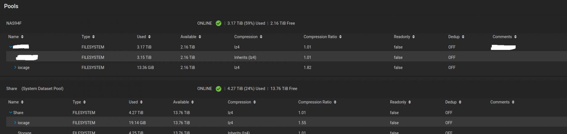

I tried to access again. "access denied by server". I am 99% sure this is a permission isssue but, the permissions are exactly the same as my homelab so I am lost.
