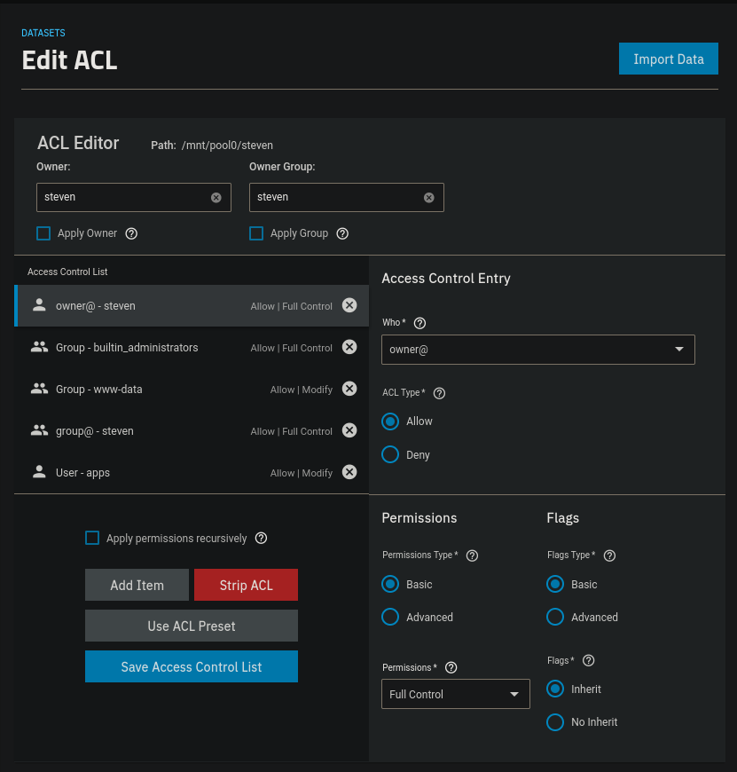

UPDATE: Looks like this is due to the different ACL types used in Core vs SCALE.
Ironically, I'm in that thread as well, as a Core user trying to help out my cousins on SCALE. :tongue:
I'm unfamiliar with dataset management with the SCALE GUI. Is there a way to change the ACL type for a dataset? (POSIX.1e ACLs vs NFSv4 ACLs)

I won't lie, I'm not great with understanding how the heck ACLs work. I do remember that there are two different types you can set. This is what the GUI looks like:
I believe these are the NFSv4 ACLs, and I think if I click the big scary red button "Strip ACL," it will turn it into the POSIX type. Not 100% sure though.
I guess according to that other thread, switching away from the NFSv4 ACL may solve the issue.
I'll be in for a hell of a ride if I start messing with the ACLs. Took me forever to get Nextcloud and Photoprism to be able to access this dataset, so I'm looking forward to having to figure that all out again. /s
