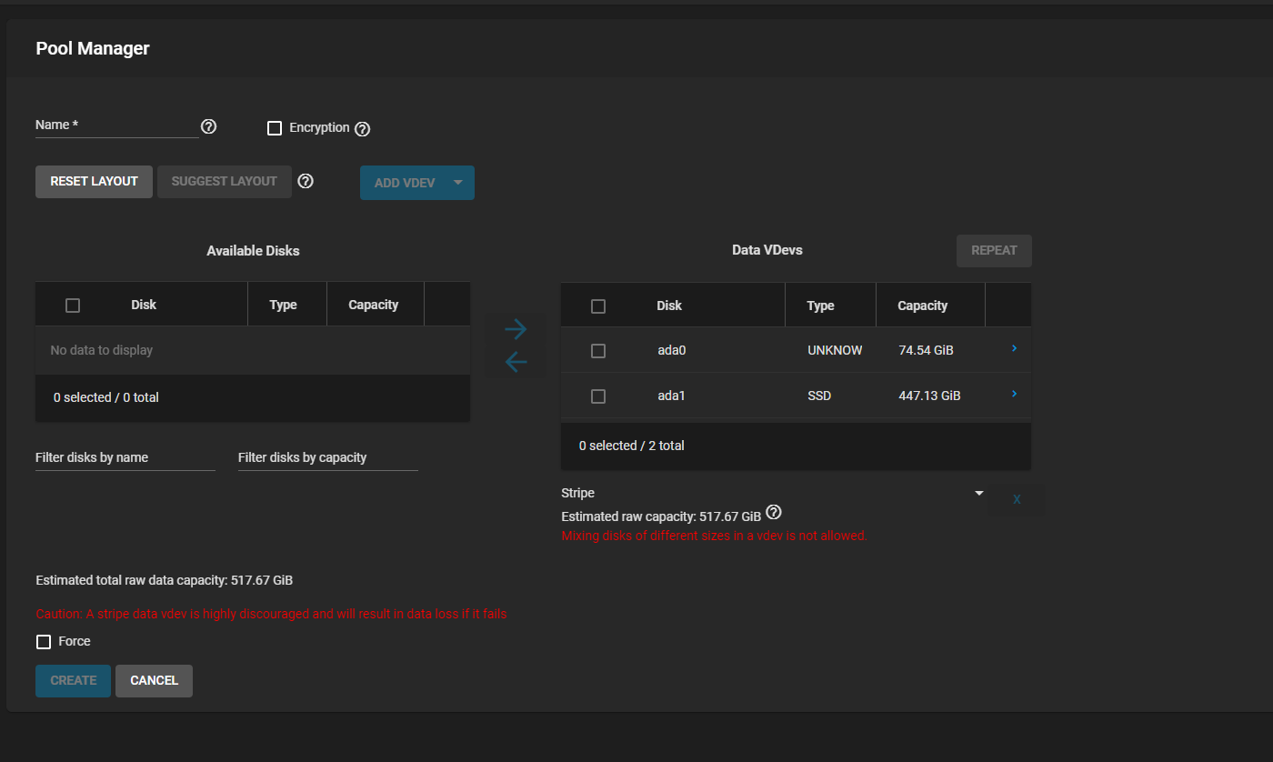

I'm new to this and I don't quite understand what you're talking about,
means when I go to create a new pool
throw this out....
Is there any option for me to create a pool without two identical disks?
If there is, I would need help writing some procedure for me
Tick the Force checkbox at the bottom (and make sure to specify a name for your pool) and you can proceed.
Understand that this creates a pool which will be entirely lost if either of the 2 disks fails.

Also the pool will have the size of your smallest disk, if you force it. Best way is to purchase several identical disks, from same brand and make sure you have at least one spare on hand in case of failure.
Why do you want to create a pool of two disks? What is the intended usage purpose?
Not if it’s a striped pool.
