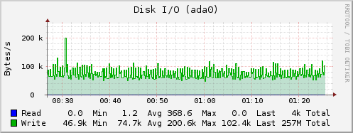

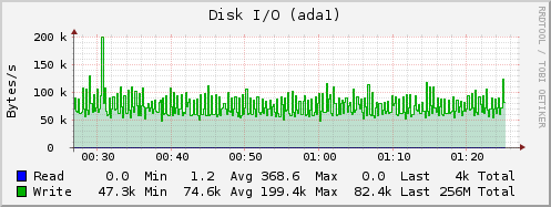

so what can i do about this activity?? its the same on all my drives

What do you mean, "do about this activity"? You mean, like, you can sit there and watch the lights blink occasionally? Do you object to the NAS doing its NASly duties and keeping those very graphs you're quoting?

@Halfe This is normal activity, I have the same thing, just over 100k write on average when it's just sitting idle.

Ok. But i have a "JBOD" consisting of 10 500GB drives and 2 2TB drives. Only the 500 drives witch are in Z2 have this activity. And the 2TB drives are not.

Correct, because you probably have the system dataset on the RAIDZ2 that has that pool.
