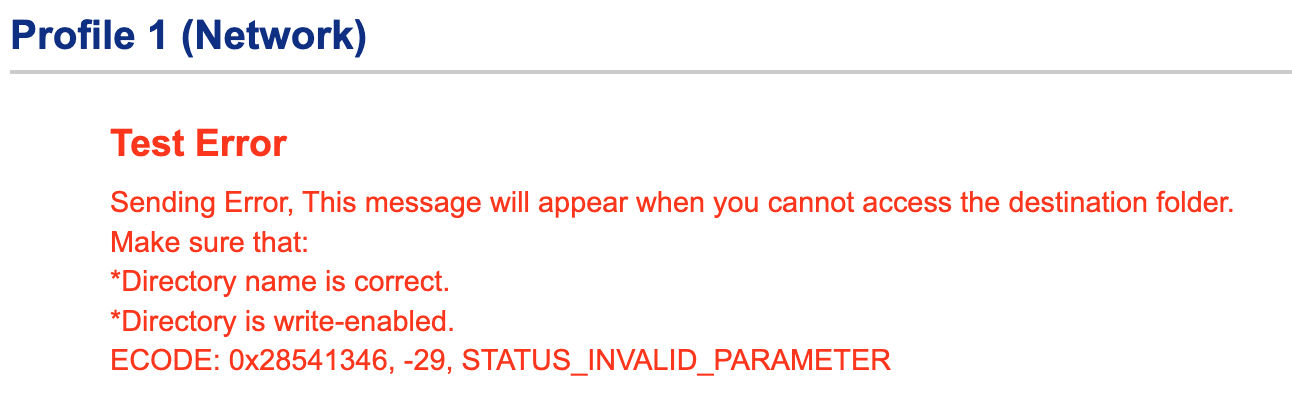

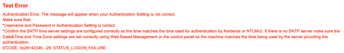

The MFP, not so much. It has a web interface to configure everything (so at least I'm not entering IPs and passwords on a 3" touch screen), but it refuses to connect, giving this error:

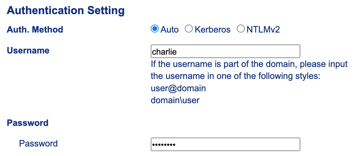

There are three options for "Auth method"; I've tried both Auto and NTLMv2:
I'm not using a domain or any other sort of directory service, just a local user on the NAS. I've tried enabling SMB1 and NTLMv1 to no effect. The MFP is running the most current firmware. What else should I try?

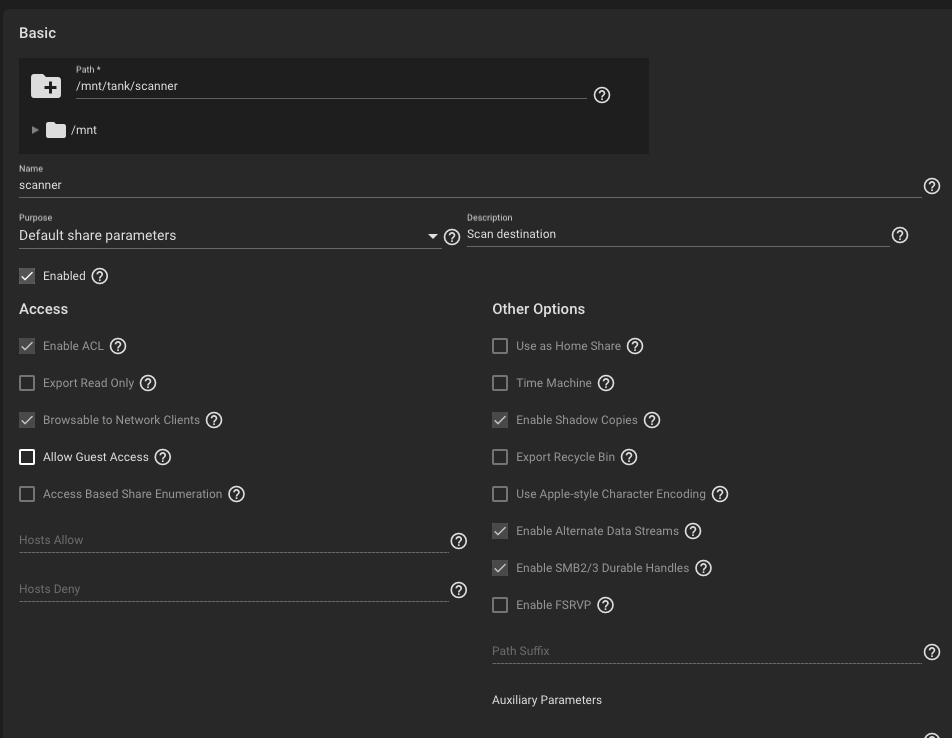

Makes sense. Here are the share settings:

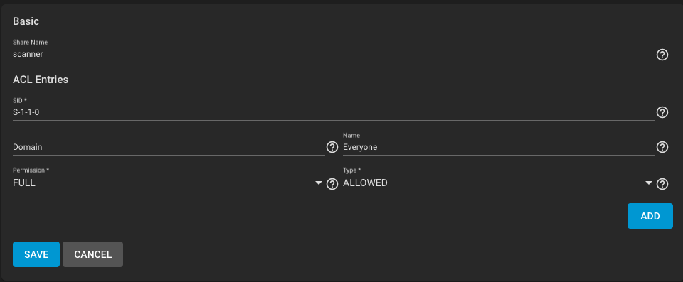

Share ACL:

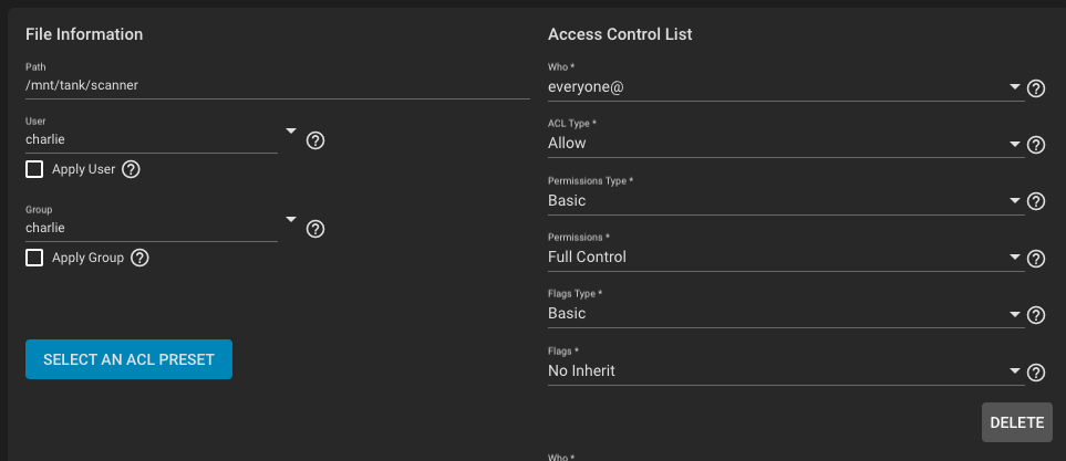

Filesystem ACL:

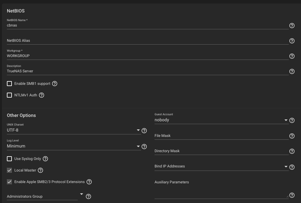

...and the SMB service settings:

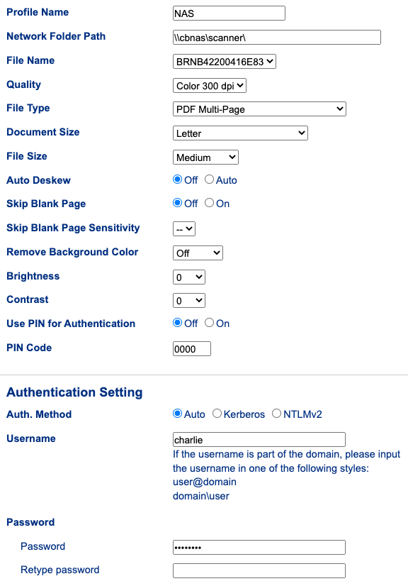

Settings on the MFP:
I've also tried with the NAS IP instead of its name, I've tried without the leading \\ in the path, I've tried the username as workgroup\charlie, I've tried with Auth method set to NTLMv2 rather than Auto.

I have a Wifi-connected Canon multi-function printer/scanner and my settings are very similar. The only noteworthy differences I see is that I have:
  • in SMB service:
    • Enable Apple SMB2/3 Protocol extensions: off
  • in Sharing:
    • Purpose: No presets
    • Enable SMB2/3 durable handles: off

I hadn't; here's what happens when I try charlie@cbnas:
Using cbnas\charlie gives the original error message, STATUS_INVALID_PARAMETER. So whatever the problem is, it isn't authentication.
