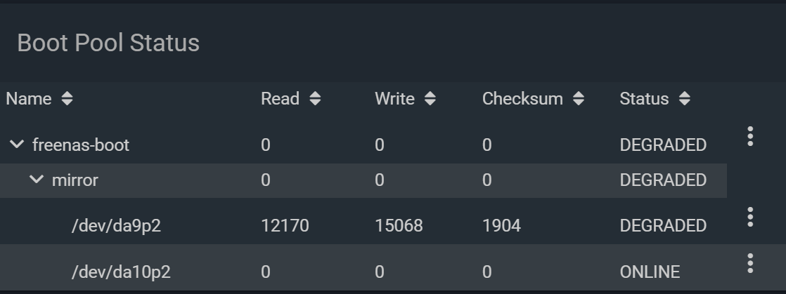

Checking the Boot Pool Status, it shows me the following:
my questions:
1. which of the two devices is the broken one? Status of /dev/da9p2 is shown as DEGRADED while /dev/da10p2 is shown as ONLINE, but it seems only on /dev/da9p2 were any bytes read or written. So, which is the broken drive?

If the USB drives feature some activity indicator you could read from the working one and check which one is lit.
dd if=/dev/da10 of=/dev/null - press Ctrl-C to stop.
