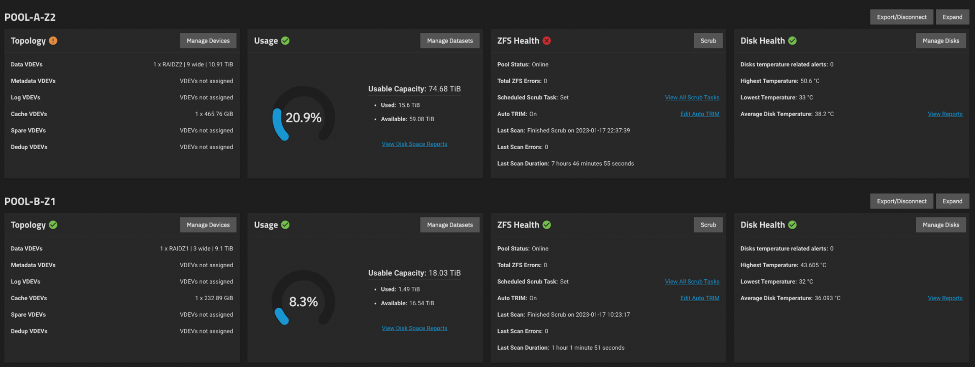

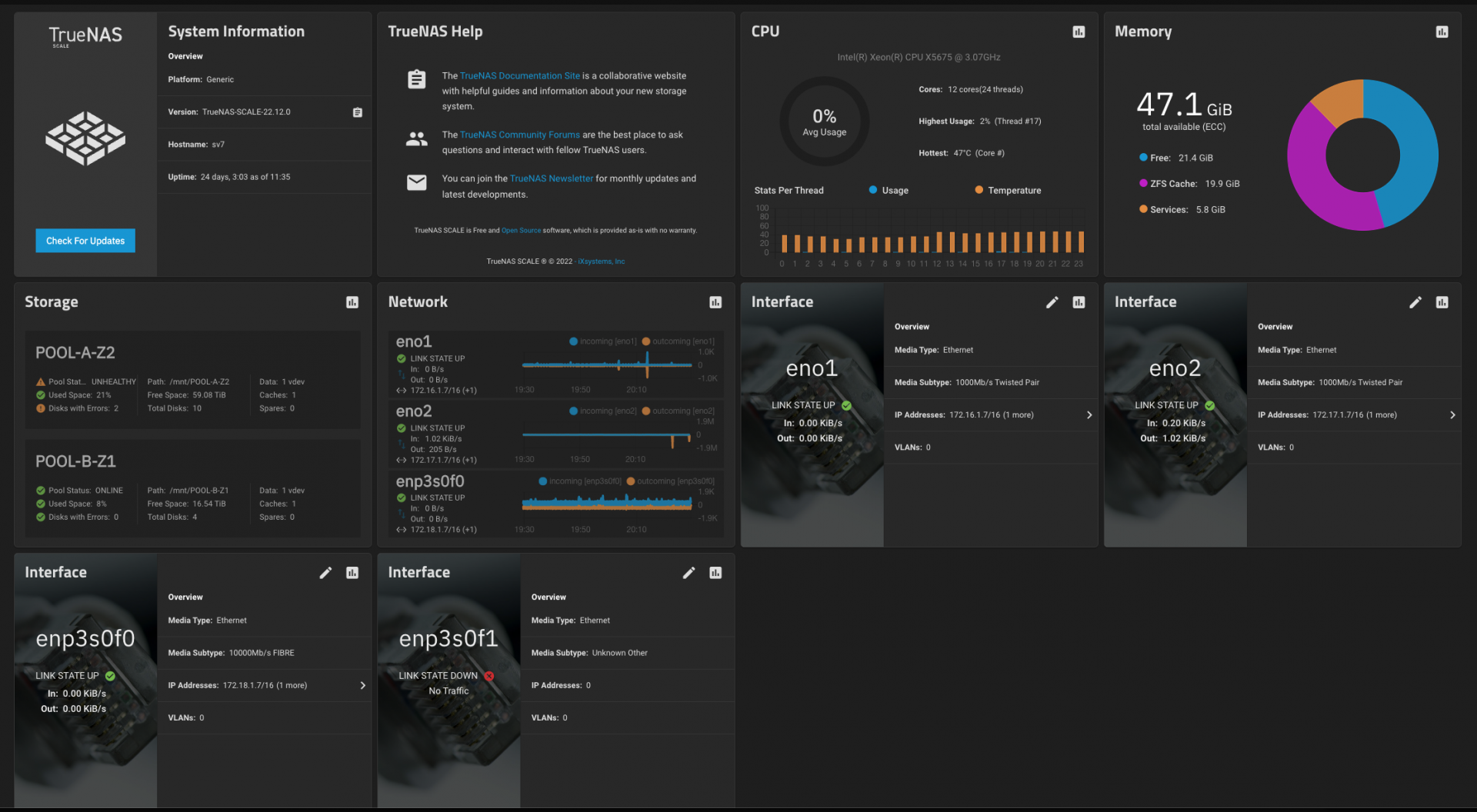

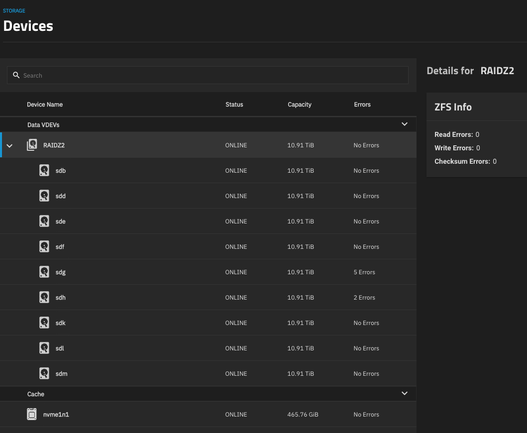

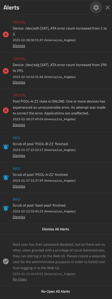

So new server, new and different hard drives (even different brand) i'm starting to see errors again:
Some images to show how everything is going so far, I don't want to just ssh and manually clear errors even though I don't think two new hard drives would all the sudden start failing and still pass SMART tests fine so I'm not sure what's going on here but since this is the second time on TrueNAS scale that I see these errors there's probably a reason for them.

I would suggest looking into the detail in both:
smartctl -a /dev/sdg
and
smartctl -a /dev/sdh
I don't think that
means what you think it means.

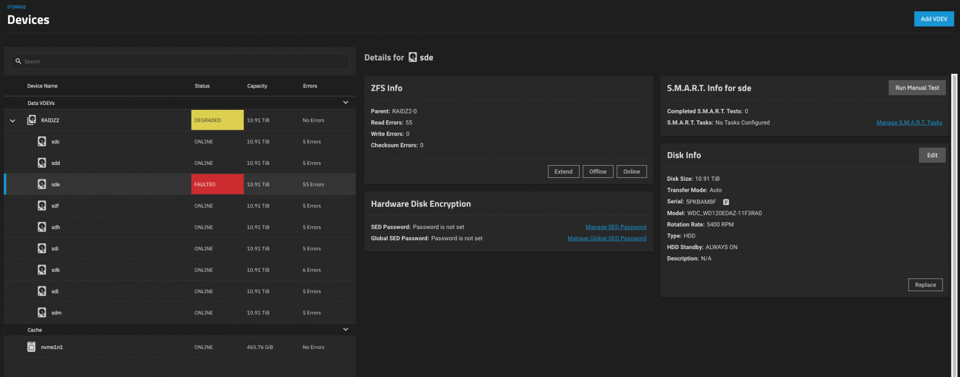

Here's what happened after I replaced the drive, every drive now has errors and one has faulted according to this image.
I'm not sure if this is a bug or something else has gone wrong with the server so I'm hoping someone can shed some light because it doesn't make any sense to me It's exactly what happened before in another unrelated server with unrelated parts and for there to be this much of a coincidence is just not likely. As for the data it's perfectly safe I have 2x copies of it on LTO so not concerned about data loss just want to fix it properly and figure out what's triggering it.
This is my main production server but i'll leave it like this for today/few hours to see wait for people here to see the thread and give some suggestions so i can test things paste commands etc otherwise my only plan is to once again start over using some different parts since i'm out of different hard drives i can use id just go for my other dell r510 and a different sas controller (my main suspect other than a sas expander) and the fact the hard drives are sata not sas possibly leading to connection issues. If it's not hardware then there's only one possibility which is software being the most likely case since i had the same problem with another server though it could be related to poor connection or other issues who knows..

The last error (same as the 291 before that, I would guess) is the request to read from the disk at several block addresses, but the command was aborted due to a CRC error.
If you don't resolve that issue (cabling/backplane/controller), you're eventually going to lose (at least access to) your pool with too many disks unable to provide data on request.

For sure that is the disk agreeing with ZFS that you're not communicating properly between the disk and the controller in some way.
