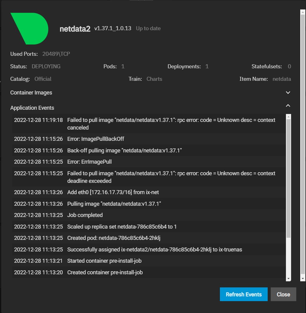

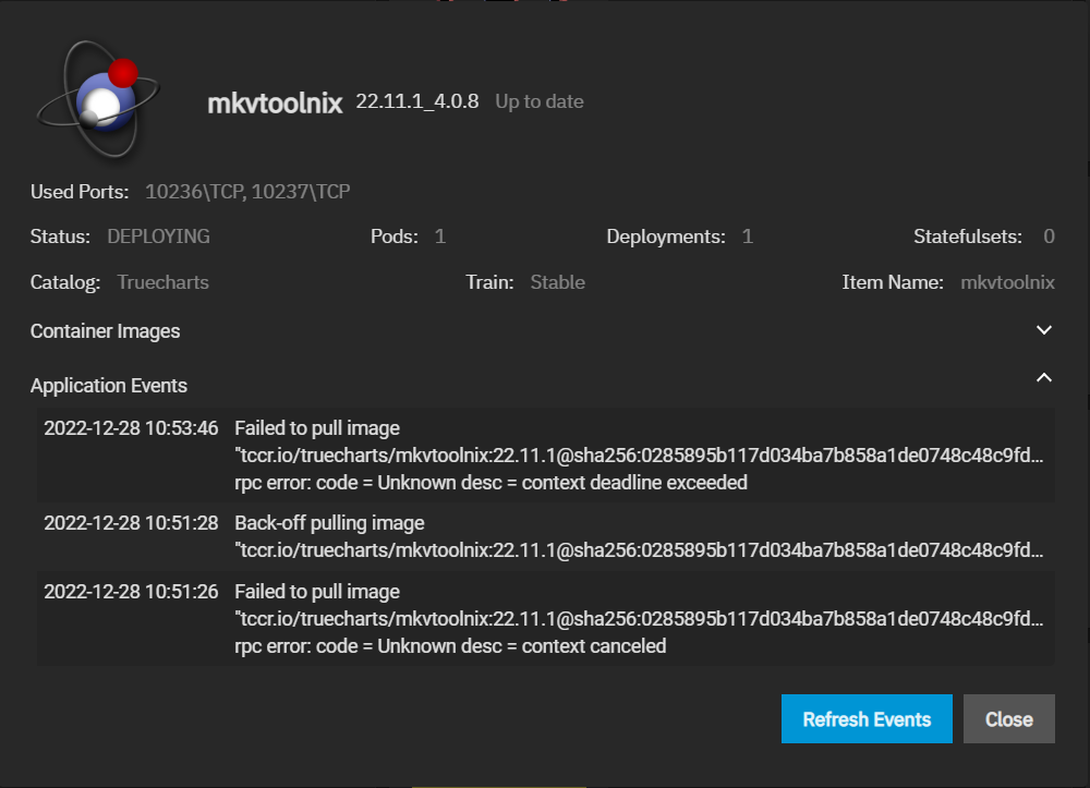

I am having some issues installing apps - mostly been truecharts apps then I decided to try netdata from ix-systems still same result.
2X Intel(R) Xeon(R) CPU E5-2690 0 @ 2.90GHz
Supermicro board - not sure specifics at this current time will update if its even relevant
134GB ECC Memory
1 2TB spinner for OS
2 1TB Sata SSD for Apps and VMs
20 10TB drives for my data pools

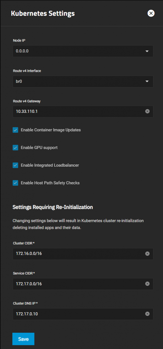

Most of my apps have been working fine even post upgrade to 22.12 - though a handful of them are having issues getting past the deploying stage. I have verified Kubernetes settings include gateway/default route as well as interface set correctly. My network settings also has this information.
I have tried these apps with my settings I'd like them to have, then even tried with standard default settings only making sure name was correct. While I originally thought this was just a truecharts issue but after seeing this issue with netdata from ix-systems it is definitely bigger than that. This issue didn't seem to exist when I was on 22.02.
Truecharts app:
When I click logs, it appears to be blank for both applications.
For good measure here is this:

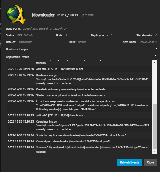

Just to chime in I am experiencing the same thing like OP. Some apps still deploy, some apps don't.
Any idea why jdownloader and deluge stuck at deploying? Running latest bluefin 22.12.0. Before bluefin update runs fine. Also to note pihole and cups-server runs fine as usual.
Posted on truecharts discord now.

Your app is being stopped by host path validation. There are few ways to get around it:
  • The correct one: do not use the same path for a share (SMB in your case) and an app. If you are sharing something like /mnt/bla/downloads then point your app to /mnt/bla/downloads/jdownloader
  • The spicy one: disable "Enable Host Path Safety Checks" in Apps > Settings > Advanced Settings
  • The derpy one: disable the share, start the app, enable the share back once the app has started.
Truecharts Discord helped me on this and I used another share type, NFS and it worked. Now left with jdownloader not working still.
I read all the replies here in the forum, and I have to say I've upgraded from the alpha stage of SCALE and I didn't know about the host path safety checks or was aware of it before. Apologies.
