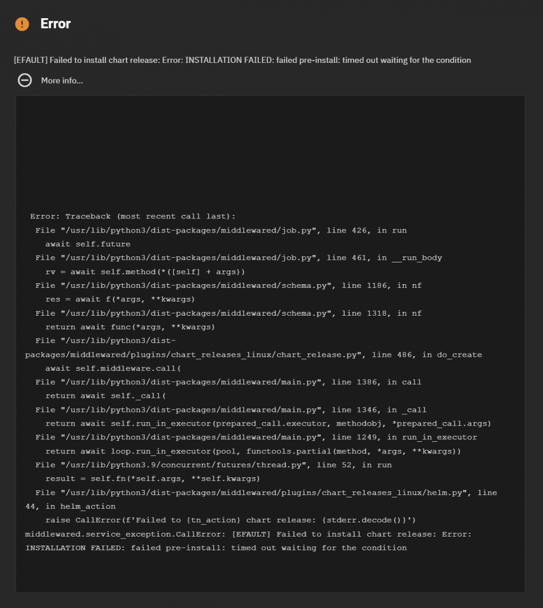

Whenever I try to install an app it gets to 75% and then sits for 10 minutes and eventually fails giving the error: [EFAULT] Failed to install chart release: Error: INSTALLATION FAILED: failed pre-install: timed out waiting for the condition
Not sure what is going on. have tried a few different things and can't work it out.
