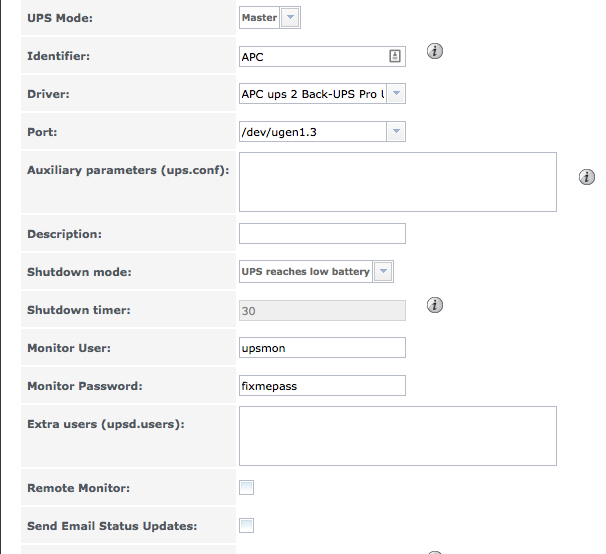

Post a screen shot of your UPS configuration. Also in the shell window try typing "upsc -l" and hopefully you will see your UPS listed. Also try different USB ports, some work better than others.

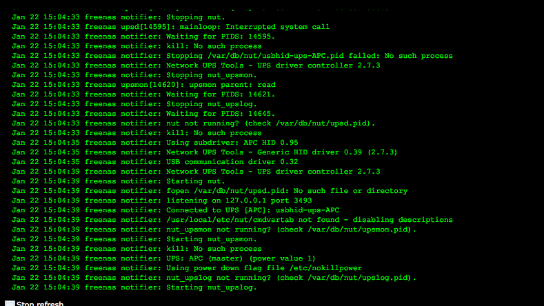

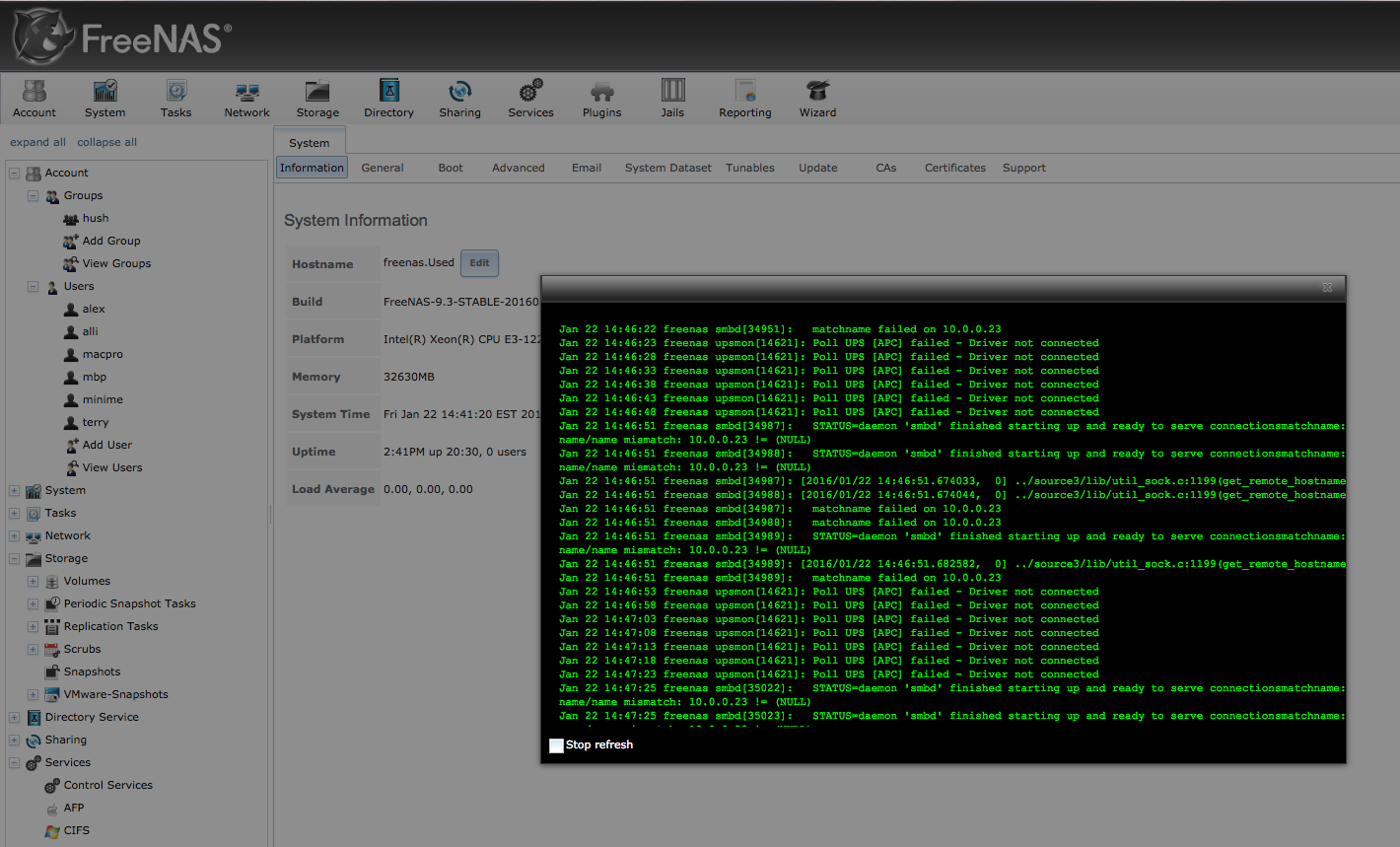

Firstly, thanks to everyone who so far has tried to help. Sorry I am slow in getting my response. Here are two screenshots including one of the terminal showing some of the error messages and one just showing how it is configured in Services. Yes, I do know which USB port it is on and I have not tried using all of them, but am willing to give it a go. Yes, I read the manual and know how to identify the correct USB port (my bios also identifies it for me). I have tried all of the available APC options that say Backups Pro or similar, most of which do use the usbhid-ups driver. It has seemed to connect sometimes for awhile, but it always seems to lose its connection and begin to give these error messages. I tried the apcsmart driver also even though I know that mine is not a "smart" APC UPS. Still no go. I will try using different USB ports and report back if it helps. Once again, many thanks for the community for trying to help me.

When I switched from one of my only two USB 2.0 ports (all the rest are 3.0) to the other and then changed my settings in the USB Service to reflect it, this is what initially happened:

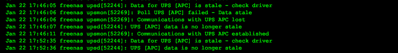

And then, is this normal? It says that the UPS data is stale, has difficulty communicating with it, and then later says it is no longer stale. Is there some setting I can change or driver change or something I should be doing differently (there's probably LOTS I should/could be doing differently. Still learning . . .

There are several threads on Stale data of UPS, do a google search and you might find an answer but I don't recall a real fix, hopefully I'm wrong.
