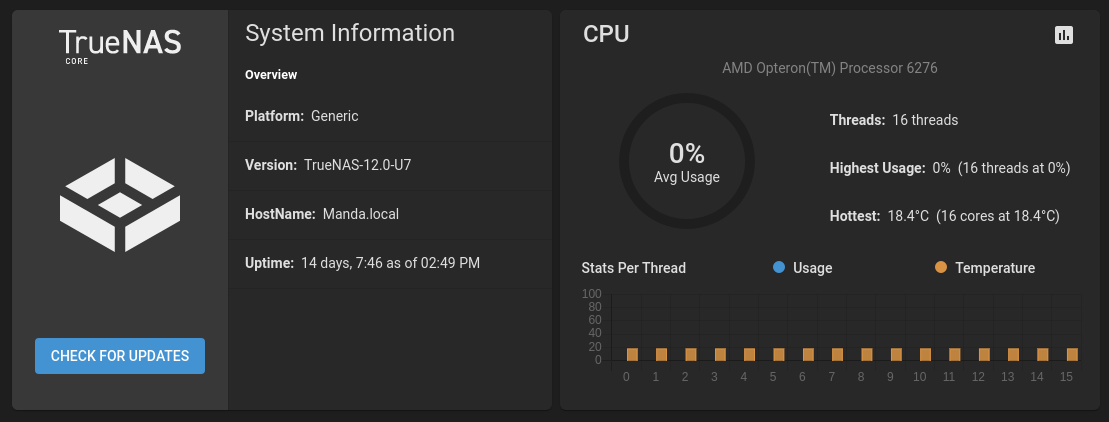

The ambient temperature in the room this server is in is around 21C so this is clearly wrong. I know over the last several months there have been some updates to TrueNAS to correct these kinds of issues but it has not fixed this CPU. Does anyone have any information specifically on this generation of CPU. Is this CPU to old to bother with opening a support ticket for? The motherboard is a Supermicro H8SGL-F.

What is the system reporting its temperature as? If the underlying system is reporting bullchips, this wouldn't even be a TrueNAS issue. This is unfortunately somewhat commonplace especially if you've sourced a mainboard from some of the common consumer-grade vendors.
An Opteron 6276 is pretty old and from a time when AMD wasn't at the top of its game, so it's fairly likely nobody ever paid that much attention to this sort of detail.

TrueNAS is reporting 18.4C with a 21C ambient on a Supermicro H8SGL-F, which is absolutely not some consumer-grade vendor. It is a name brand server board. A fairly high end one at that.
FreeBSD is reporting the same temp as TrueNAS. The below temp is different than the original post because I took it at a different time ;)

Both TrueNAS and FreeBSD was around when this board and CPU was in data centers and I don't remember the temp being wrong years ago when I used this before it was EOL and still under warranty (the board anyway). My question is would be go under a regression or unsupported/EOL.
Edit: I used this CPU/Board back on FreeNAS 9.2
It would be a regression, but you’d need to find someone who cared and help them test things (or someone who has the same hardware).

The Supermicro H8 stuff was not a popular line. I would equally believe that it worked or it didn't. There were problems with some of these. However, even if it did, the FreeBSD support for CPU temps may well have changed or rotted as new CPU's were added in the last decade. PC temperature reporting is crappy.
The sysctl calls make it clear that this is not a FreeNAS/TrueNAS issue as such, since it is just reporting what FreeBSD is reporting. It would probably be interesting to see what was reported if you booted up an old copy of FreeBSD 9...

Well we know for certain that there's temperature sensors. This is more a case of the old nugget about standards, so many to choose from. I imagine someone spent time ten years ago getting this working on the H8 boards, and then that may have been overcome by more recent developments that could have broken this. Could be the BIOS/IPMI/BMC, could be FreeBSD. That's why I suggested trying a boot of an old FreeBSD 9 to see what it reported.
