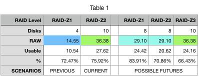

Hi!
About 6 months ago I went from the "previous" to the "current" scenario:
I'm considering to backup all my data (13TB right now) and do some refactory on my storage. My intention with this refactory is to increase the resilience by one way or another. Also, I'm not considering to increase the data volume indefinitely. At some point I'll discard some very old data.
I know that there is no unique, final, scientifc answer to my question, but I would like to know what you would do in this particular situation.
For example: if I downgrade to 8 disks, I can have 2 disks as spare, in the case of failure. If I keep all the 10 disks but increase the level to RAID-Z3, I can keep all disks working and increase the storage's relilience to 3 failures instead of 2.
And before you say, I don't like the MIRROR scenario (RAID10). The possibility to lose 2 disks, one of each side, scares me; I prefer to take the risk to lose "any" 2 disks (or 3).
My motherboard is a Supermicro, model X11SSL-CF (6 sata ports and 8 sas ports), and the case is an NZXT H-440 (with room for 10 HDDs of 3.5' and 2 of 2.5'). All disks are Seagate, 4TB.

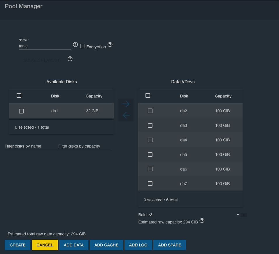

15,504
That's the problem with only having 8 slots for a pool vs. 48. :)
That's where VMs are so helpful. I have lots of spare bays in my FreeNAS box, but not a lot of spare disks to put in them (if I did, they'd probably be part of my pool)--but I can create a VM under VirtualBox (or Proxmox, which I used for this test), assign it a half-dozen virtual disks, and test that way.
The screen shot I posted is in 11.2-RELEASE, using the new (i.e., default) GUI, the only place I know of to create a pool: storage -> pools -> + -> select "new pool". If you click the "suggest layout" link in that window, it will look just like what I posted except that it will say "Raid-z2" below the disk list. But that's a drop-down and you can change it to "Raid-z3".
