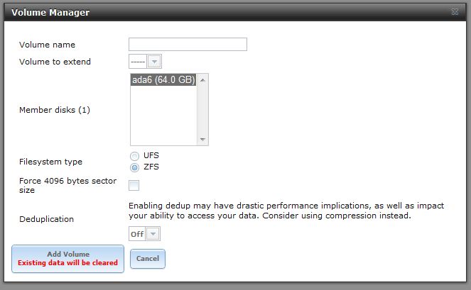

I have FreeNAS-8.3.0-RELEASE-p1-x64 (r12825) installed in NAS with RAIDZ2 array of 6 disks. I wanted to add an L2ARC after I pulled an SSD out of my desktop. But when I select the SSD using volume manager in the GUI, there is no "ZFS extra option" to add the SSD as an L2ARC. Here is the screenshot.
I saw a thread which was started a while back on this issue... http://forums.freenas.org/showthread.php?5717-How-I-added-a-cache-drive-to-an-existing-pool
Is this still the solution for this problem or am I doing something wrong?
Appreciate any help!!

You're doing something wrong.
_DO NOT_ select the disk in the "member disks" field, it will show up and the bottom to chose as a cache, additionally select the "volume to extend" field.

I can't check this myself right now but you have to choose the volume to extend. Then it appears.

I can confirm that it can be done through the GUI, because that's how I did it. William's directions sound approximately correct. It'll be obvious when you're doing the right thing. Select the pool under "volume to extend", leave "volume name" blank.

William, noobsauce and jgreco - thank you so much!
I left the volume name blank, selected the volume to extend and did not select the disk in the "member disk" field. It worked!
