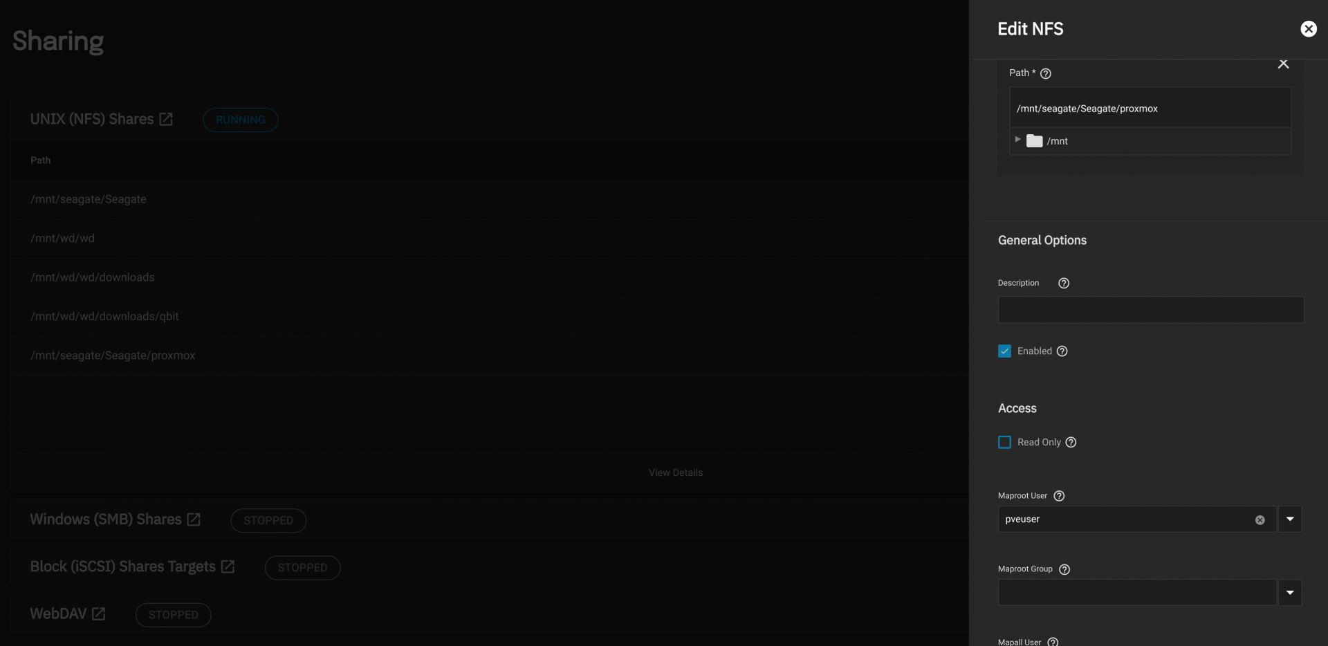

I am trying to add a nfs share to my proxmox server from truenas scale but whatever i try it gives me permission denied error. Whay may i doing wrong?
Here is what i tried;
First i added a dataset named proxmox like the picture below
and then created a user named pveuser and gave permissions: (in group Editors)
and then added a nfs share for this dataset like below also tried mpall to root but didnt matter :(
And here is proxmox settings :(
Whatever i tried i couldnt pass this permission denied message. Any help appreciated.

The second picture shows the permissions of the dataset i created for this purpose. Also i tried
maproot user = pveuser, maproot group = Editors
Or
mapall user = nobody, mapall group = no group
or
mapall user =root
Nothing worked

Hi as far as i know proxmox only tries to connect through its own root account and ppl say that you dont need to add any user for connecting it ro truenas, you just need to map it it in truenas settings unfortunately i couldnt manage to do it no matter what maproot or mapall settings i tried.

The only way I have been able to get this to work in scale is in the advanced settings of the share to set both "maprootuser" and "maprootgroup" to root this is equivalent to setting no_root_squash and will actually show up that way in the /etc/exports file. I don't know that I would do this in a production environment but in my lab I am ok with it.
That's the way this is supposed to be handled in a UNIX environment where the client is acting with superuser ID, which includes both Proxmox and ESXi, from what I've seen. It is unclear what you would do differently in a "production environment", as you presumably wouldn't rewrite NFS client and server code to work differently in such an environment.

yes, i followed every thread and search about my issue. When i try to add the share in Proxmox i am suppose to get a dropdown menu shoing the shares on the ip adress from truenas, but i get notting. If I manually set the path I get a permission error when I try to send data to the share.
This is my truenas setup:
ray@truenas:/$ cat /etc/exports
"/mnt/RayStore-HDD/proxmox/backups"\
        10.10.1.0/24(sec=sys,rw,anonuid=3001,anongid=3001,no_subtree_check)
ray@truenas:/$

That doesn't look to be root UID/GID. Bearing in mind that I haven't looked at the current SCALE UI and that whatever picture you included didn't make it, did you set "Advanced" and go to "Maproot user = root" and "Maproot group = root" ?
RayRayNoob
Jan 1, 2024
6
Yes you are correct. This is the owner for the datashare and also the uset set in Maproot User and Maproot Group.
However, I´ve also tried to set Maproot User/Group as root:wheel, and changed the owner of the dataset to root, but the result is the same.
