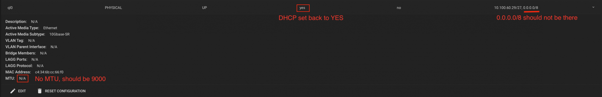

Using Core-12-U7. Adding a IP to one of my interface, testing and after change, settings are all wrong. 0.0.0.0/8 is added to my IP, MTU not saved (even though I have it set in my switch). DHCP set back to YES even if I uncheck the box and set a static IP.
Screenshot with what I mean :

What is should be the process after doing the change test ?

Also, When I reboot, no network configs are kept. (and yes, I did click on save :) )

Playing around, is seems that if I have a DHCP activated interface (in my case, the management one), none of the other interfaces keep there settings. I tried tried adding a static IP to the management interface and the the second one kept its settings. Could this be a bug ? not able to have a DHCP interface and another STATIC at the same time ?

Yeah, I have two interfaces that are UP. Management & backend. so each has its own settings

Management is on a VLAN and backend is on a isolated port group
Like I said, removing the DHCP on the management interface and using both Static IPs, is working.
